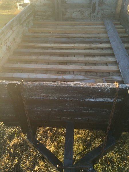

  11. saskwoodburner
    saskwoodburner
    Dec 15, 2015
    2,612
    14,902
    Reinforced the deck with spaced out 2x4's so it should be good for 6 rows of 16" wood. And the left side rails tastefully made from ancient boards! The bottom board is attached to the sidestakes, while the other 2 will just float in the groove.
    According to math, a level load to the top of the rails should be 71 cubic feet, or just a hair over a half cord.
  12. saskwoodburner
    saskwoodburner
    Dec 15, 2015
    2,612
    14,902
