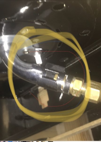

    Photo of the line and the fitting I mentioned

    Are you smelling any propane coming out of the side burner when you turn the nob on high? If not, There is a clog somewhere of something is capped. I once had a spider web in one of my propane gill tubes and it wouldn't light off. You are not getting any flow obviously.

    Does this line have a separate pressure regulator or is the just one coming off the bottle?

    It has a separate regulator. It has flame out the end of the line over an inch long
    I ran a pipe cleaner through the tube and could see it inside the burner so no obstruction

    Might be a PITA, but any way you can swap hoses with the main burners to see if the regulator isn’t the problem?
    Mind you I don’t know if the 2 regulators have different preset pressures, so use caution.

    May not be getting enough propane to support combustion at the burner unit.
    1 inch flame at the open end still seems small.
    Is the regulator adjustable?
