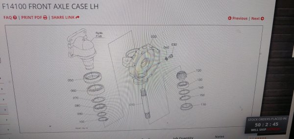

    Screwloose, Maina, Boogeyman and 6 others like this.

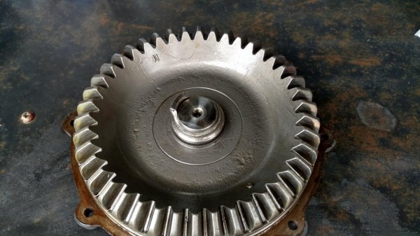

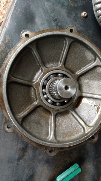

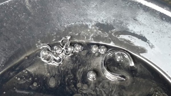

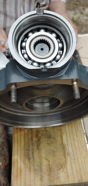

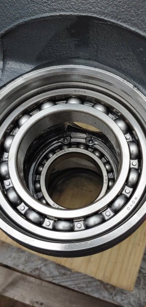

    The 'Bota should be alive and well tomorrow. We have to assemble the new axle and bolt everything back on, add oil. We got the knuckle and diff case assembled this morning. 0616201139.jpg 0616201253.jpg
