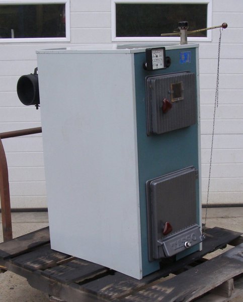

    Creosote and high wood consumption in my mind required a change. Our second boiler pictured below was a cast -iron sectional down-drafting triple pass and small in output by wood boiler standards at 75,000 BTUs per hour. It was a creosote producing monster that reduced yearly wood consumption to 14/16 cords per year. The reason a boiler like this produces large amounts of creosote inside itself and in the chimney is that unlike a conventional woodstove where the firebox walls are nice warm steel, the firebox walls of the boiler are surrounded by water, creating a low temperature fire which is very inefficient, resulting in unburned resins and tars that stick to the inside of the boiler and flue passages but burn very hot when they ignite in the form of a chimney fire!

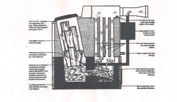

    In 1982 I discovered wood gasification in the form of a Jetstream Boiler! True wood burning happiness with average yearly consumption of 4 1/2 cords over the last 30+ years.

    PDF below from the Jetsteam manual on how gasification and storage work in together.
