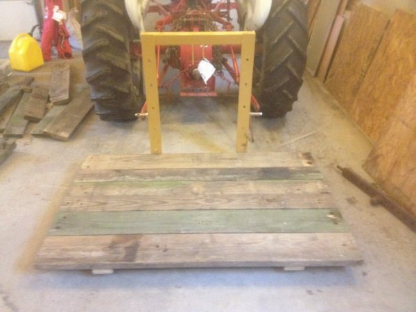

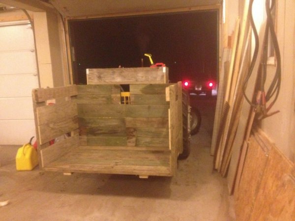

    Ja. Someone pointed that out to me about ballast already. I doubt I will be lifting that much. I am thinking closer to the 3-600 lb range. Not sure. I have to figure out how much wood will fill this. Not done yet. But getting there.

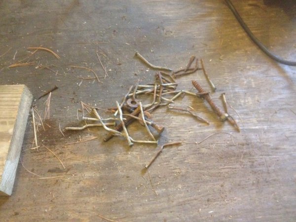

    Using old pressure treated from an old deck. Pulling nails and bolts was fun.:zip:

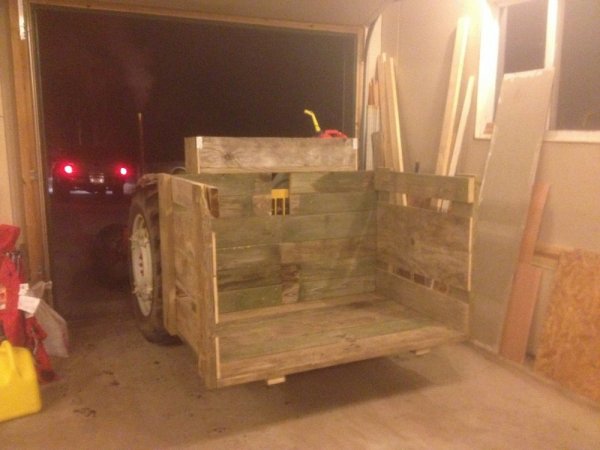

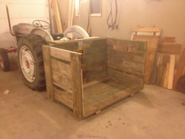

    Now the sides and a tool box up on top. I'll be making some sort of back for it that will slide on some how and tie the sides together so the are strongly tied to each other when wood is loaded.

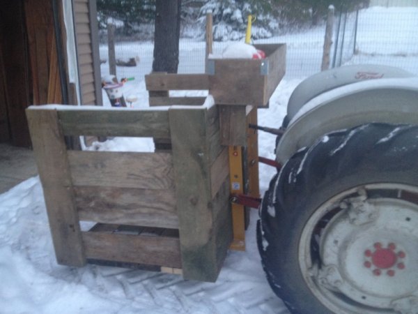

    Pretty strong the way it is now. Lags to the frame. Heavy decking screws holding it together.

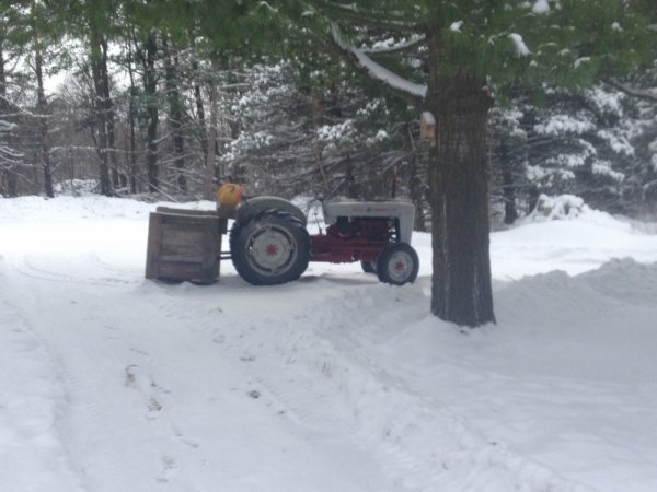

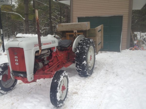

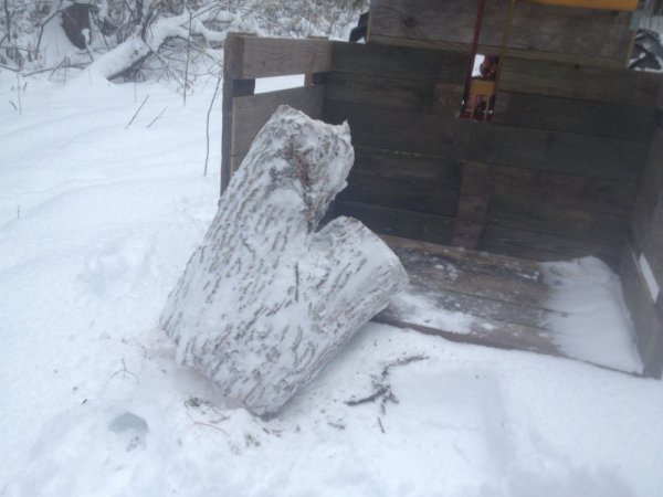

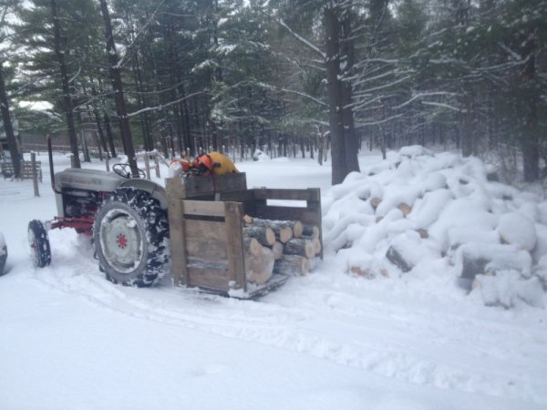

    There are several holes I could use for adding weight. I will look into this tomorrow or Friday. I am going to try going out with the tractor tomorrow and cut some wood. See how it does in the snow and how the box does with half a load of wood in it.

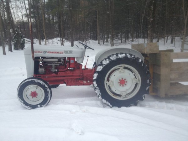

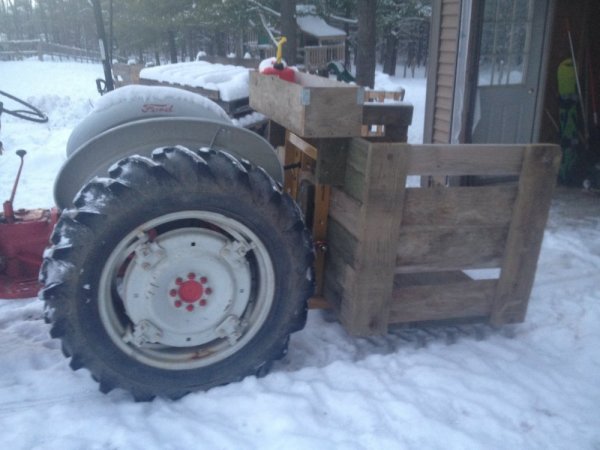

    Here are a couple pics I took today. I just wanted to start the tractor up and run it to charge the battery. It started, no problem, in this cold.
    I need to adjust the top link to level the box out. I just put some 3-1 on it and put it in the vice and loosened it up good the last time I had it in the garage.
    I'm going to add some holders to the box like in the video I posted before. I want to be able bring my chainsaw, a heavy pry bar, a rake, a shovel, etc. I have put chains in the top tool box already. Will also use box to do some other types of work as well. Landscaping stuff mostly.

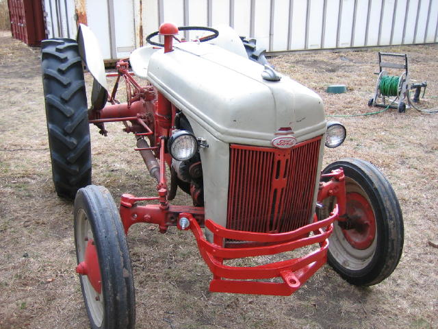

    My grandfathers Ford was a 9n, it had a bumper like this one that he kept a lot of chain wrapped around. It looks like yours has similar mounting holes. I kind of recall him saying it was for weight. It obviously isn't going to balance out 1200 pounds but every little bit helps. And the front mounted ball that can be put on the bumper used to come in very handy if you wanted the trailer but there was something using the three point (like the sickle bar that stayed on all summer). I think I pushed the trailer more than I pulled it.

    You sure that's not a 8N? The color scheme is wrong for the 9N but dead on for the 8N.

    Those front bumper/frames are nice. I should see if I can get one fabricated up and have a receiver built into the center of it. Then I could use it for a variety of things. Adding weight, moving things around with trailer hitch mounted, etc.

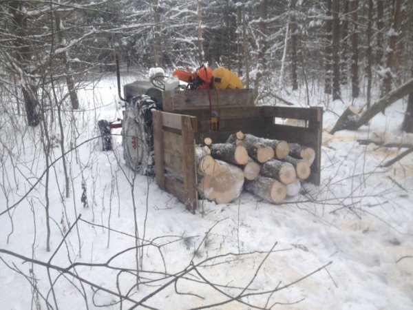

    Well I got started on some wood with the tractor. Half a load first. No weight on front end. Got it out of the woods but just a half load is already effecting the steering. :mad: I know. :emb: You told me. Shut up. :rofl: :lol:
    I started looking at the holes and figuring out how to make a frame for weight and possibly other things. But now that I see woodlands dire predictions for weather for us I have moved the generator and gas to the top of the list. Once I get that ready I may go in to a spot with the truck to get a quick load out. We will see. Tractor did well in the snow. But need to get counter weight. Not worth going in for that 1/2 load. Fun, but need more wood! :D
    Maybe I'll go in and skid some logs out instead.
