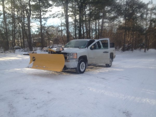

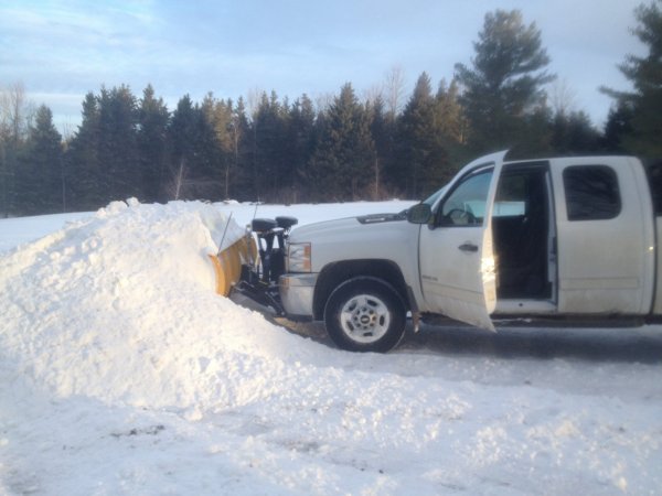

I've been plowing with the shoes on to leave the crushed stone where it belongs and save the grass. Now that things are frozen up good I decided to take them off and scrap things down a little better. And make the kids a bigger sliding pile.
Kids oughta love that. If we ever get any snow here, maybe you've inspired me to make a ramp out back fer lil boy launchin'... ...
When I get the tractor out later this afternoon to move a few logs I may improve it even more with the bucket. I actually need to back drag where they come off of the snow pile and back drag that down the hill. Makes for a nice slippery surface for them to slide even further.

I threw the shoes to my plow in the scrap pile on day 1. Even for gravel, I prefer to float it manually. Pavement. ..not even a comparison. Much cleaner barefoot!

Our Jeep's 6' plow doesn't have shoes, but I think it's lighter weight (under 250 lbs) means they're not needed. Always had shoes on the other two 8' plows we've had... and I dug in plenty even with them on... scares me to think what I mess I could have made barefoot.
I have been using the shoes with one washer on them. It's been working nice. This is a pretty heavy plow and I wanted to avoid moving dirt and gravel. More work in the spring.
When I had a plow, I would only keep the shoes on until the ground froze. Much cleaner job once those shoes came off!

I plowed snow for the 1st time yesterday. Don't remove the shoes but put it in the last notches. Works fine.
