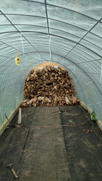

    I run two green houses with a box fan in the door and 3 floor vents on the backside. If it is the warmer months it takes about 3 weeks to dry maple, elm, ash, etc. About 6 weeks for oak. I aim for 15% moisture. Ends are cracking up in a couple days. When the sun is out it is over 120 degrees by 9am. I run the fans from 1pm to 6pm. If I am in there at midnight the wood is much warmer by touch than the exterior temperature. I have less than $300 into each and can dry 12+ cord at a time.
    On a 10 degree winter day with the sun shining it will get above 35 degrees in there. I shut the fans off and cover the opening in October.
    I actually have some grass in the front corner of one that is still growing where I ripped my ground tarp. damm dog follows me in there to chew on it.

    That's awesome. Do you have any pictures of the operation? Do you move the wood by hand or is it palletized for ease of movement?

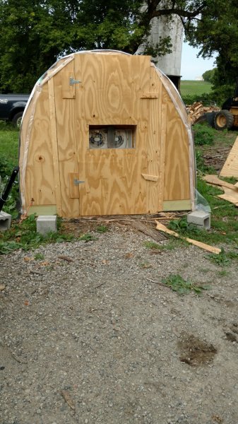

    Because it is less than 15' from my OWB I don't move it except to burn it once it is in there. I do have a couple older pics. First pic I changed my flooring. Went to a heavy duty tarp for flooring. You can see the floor vents in the back. I leave a small opening in the bottom of the stacks for air to come from the back vent. 2nd pic I changed the door after the first season. I boxed in a lasko all weather fan to increase air movement. I used true green house film instead of poly. It is supposed to last longer and have increased inside temps.

    The first year I wasn't sure how it would work so I didn't go crazy with how I made it. I knew my end wood was great but was nervous about the inside of the stacks. Once I burnt enough to get to those they were as dry as the outside so I tightened up my build and decided on a second. Rather easy and it allows me to split wood in march and burn in October. Right now I am burning some wood I loaded in the second unit in early August.
    Edit: Should add what I am burning now was not fresh cut in August. Was cut in the spring and left in 8' lengths until I cut to size and split. Mostly elm, ash, sugar maple, and a bunch of pin cherry.

    Are all those white things zip ties that are holding cattle panels together in your greenhouse?

    Yes. They worked well to tighten it together and I did not have to worry about wire poking through my green house film. I trimmed them close once I was sure this operation was successful and they are holding steady.
