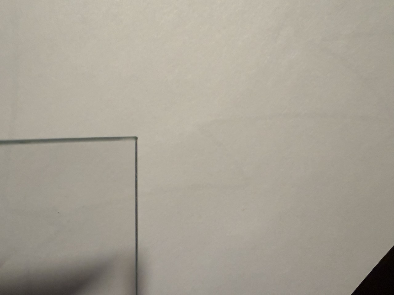

    Well, this is a total non-starter.
    It just isn't going to work and can't be modified to work. Even if I dreamed up some sort of hinge method to access the air control, the panel itself is adding danger not removing it. See:
    Wow. You couldn't chamfer the corner on the edge of this safety component even a little bit?
    This is actively hazardous. This is probably even worse than just having a woodstove.
    I'm at a complete loss. I don't know where to go from here.
