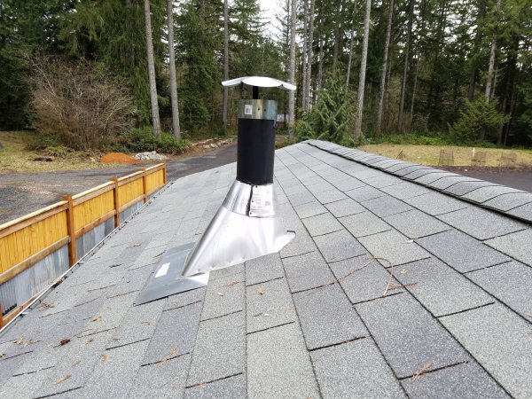

    I'll have to work on getting drier wood. I thought I would post a picture of my roof and chimney top so you could see what I have going on. I think I might take the top section of pipe, the one that came with the stove that has holes and a top, and remove the top rain block. It's not pictured in my attachment, because it's half way through the inside of the double wall pipe. I'll bet that the comments made about the top being restrictive are pretty accurate. I'll see what I can do... and then I'll have a fire and see what happens.

    If I understand correctly, The rain cap and top of the actual chimney pipe are down inside the double wall? If that's the case I would say that is your problem. That would certainly restrict your draft. Chief

    Chief, yes, you understand correctly, and I think you're right... and doing it that way was a poor choice on my part. I'll get that top cut off, and see what happens. I guess my picture didn't post on my last post. I'll get it posted in a bit.

    Ok, so I took the chimney down, ground off about 7 or welds, popped the end off, and had my kids help me get it fit back in place. My first fire is a success!! The amount of smoke I got in the shed is minimal, and the rest goes right where it should: up the chimney. I finally attached images of the chimney from the roof, and the stove with it's cute little air intake.
    Thanks for all of your suggestions, and helpful hints and tips! I sure appreciate it, AND I don't smell like a camp fire. Not sure it would have occurred to me to take the top off, even thought it makes perfect sense. I do need to get a better supply of wood though... I'll build a wood storage area and start a better collection than I have for camp fires in the back yard.
