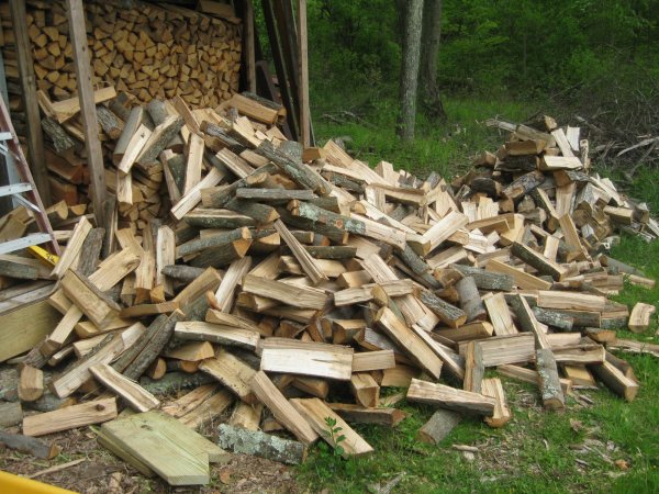

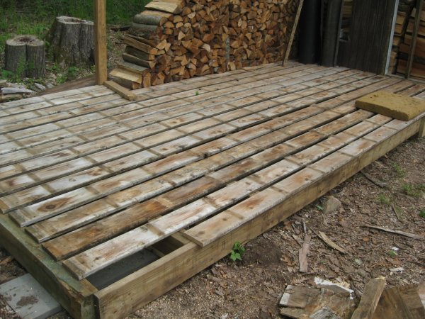

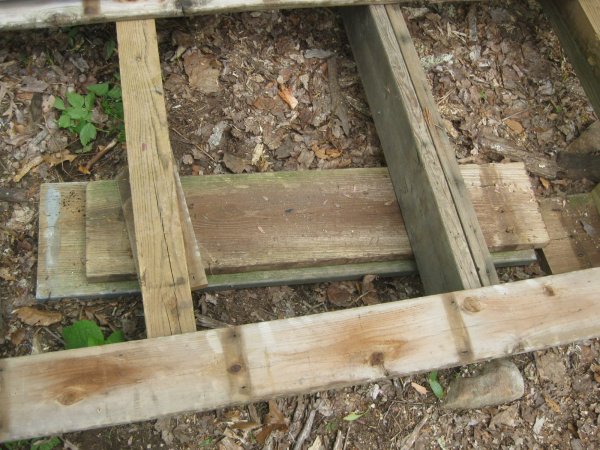

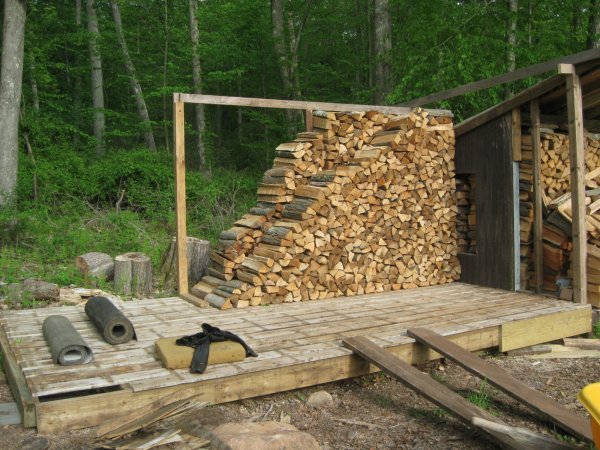

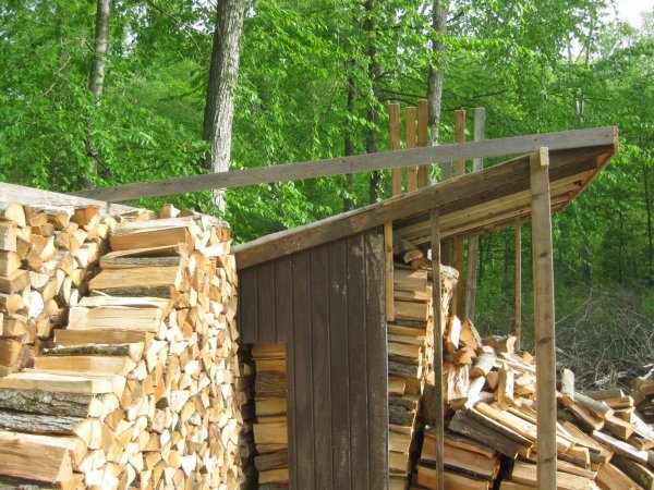

    Spent most of the afternoon working on the build. Got the rest of the flooring nailed down. (Still have the 4x4 section far left to finish the frame and install floor). IMG_3197.JPG "Padded" under the joists to lessen any sag (old 2x10 & 2x12 stair treads) since its basically a big pallet resting on grade where it can. Attached to the shed too. IMG_3196.JPG Set an end rafter to get an idea of slope. Front will have less than a foot overhang and back over 30" as framed Sandhillbilly IMG_3203.JPG The two front rows in the shed finally collapsed while i was there.:picard: :emb: Vibration and hammering made it go. Some will get mixed in the new stacks. IMG_3199.JPG

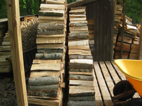

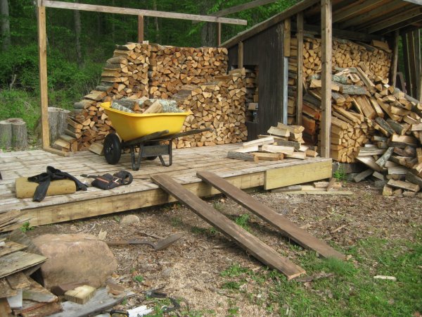

    Started another row and taking a lesson from T.Jeff Veal, decided to stack as high as i can go. IMG_3202.JPG Planned for an air space between rows. It with fit seven rows so originally i was wrong at eight cord. It will hold seven if i stack 5' tall but at 6.5' it will hold roughly 9.33 cords. IMG_3201.JPG Couple ramps and wheel it right up there to stack. Less bending is gooder for stacking for this old back. IMG_3200.JPG Have to build the center "wall" before stacking more. Gotta rip some 2x4's from some reclaimed 2x8's. Have to scrounge up more 8' 2x4's.

    You don't worry about wood sitting on the ground?
    Chaz, metalcuttr, FarmerJ and 3 others like this.
  5. buZZsaw BRAD
    35,231
    218,266
    No. All the framing lumber on the ground is pressure treated, except a doubled up joist that is not and that one is not touching the ground. The "pads" are PT as well that were saved from stairs that ive replaced on decks. Going to have decent overhang too so less likely to get wet. I may put a rain gutter on back as well

    I now get any wood racks off the ground using various concrete paving blocks, that I've accumulated over the years.
    Even if PT'd, I'm still lifting them a few inches.
    Chaz, Hinerman, Softwood and 5 others like this.
  10. buZZsaw BRAD
    35,231
    218,266
    Most of this is "old" PT which was all ground contact. If i were building a "normal" shed it would be on piers and beams or on a gravel pad. I was saving labor here too. With as much wood that it will have im wondering what will happen? Gonna find out.

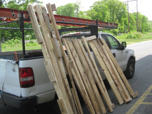

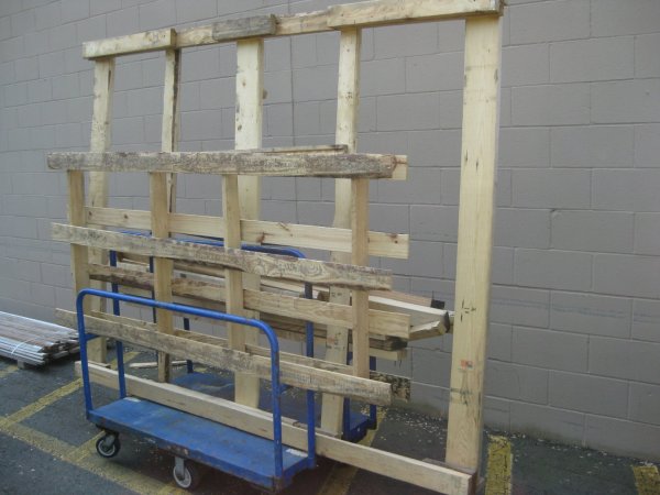

    Worked on the shed for an hour late today. Started the divider wall. Used the wood from a pallet i scored at Lowes today. 6'x8' made with 2x4 & 2x6. Didnt get the wall finished so no pics of it built. IMG_3204.JPG IMG_3205.JPG And i dont know whats wrong with my brain lately.:confused: Shed will hold ONLY six cord at 5' high stacked so 6.5' i will go and hold eight cord.
    Woodsnwoods, Chaz, jo191145 and 8 others like this.
  19. Eric VW
    24,577
    141,812
    Nice! You gonna scrounge that Lowe’s cart?
    Did you dismantle that pallet with hand tools?
    Chaz, eatonpcat, theburtman and 2 others like this.
  20. buZZsaw BRAD
    35,231
    218,266

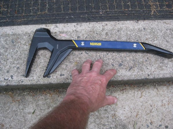

    LOL!!! No on the cart and yes on the dismantle. It was cheap "white wood" (generic utility softwood) and it came apart rather easily. Doesnt hold a nail as well as standard douglas fir framing lumber, but doesnt have to. Used once and then thrown away. I brought a new demo tool and used it for the task. It was on clearance at 25% off and i happened to walk by. IMG_3208.JPG
