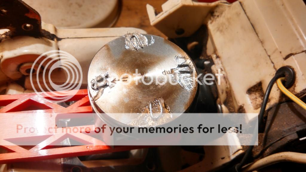

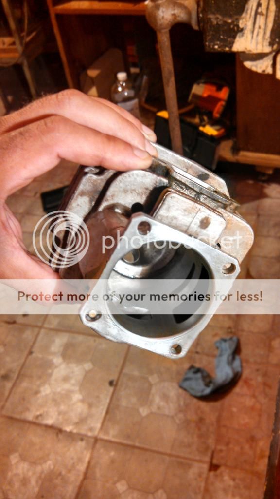

    I had a wife free evening, so got back to this saw. Cleaned everything up with scotch brite.
    Squish was .023" on average with the gasket delete.
    It's all back together minus the bar. Letting the gasket set up and hopefully fire it up Saturday sometime just to see. Will perform a vac/ pressure test when I get the proper tools to do so.
    I did notice the exhaust was real carbon'd up, like creosote looking, and the gasket between muff and cylinder showed oozing. I cleaned it all up.
    Could a lack of back pressure cause the timing-esque symptoms I described previously?
