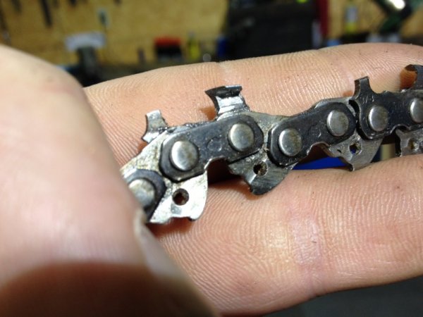

    I was digging through some stuff last night. Got a pic of a semi-chisel chain that Levi and I treated like a race chain..
    This thing will remove a lot of material, but takes something along the 70+cc in power to pull it...
    I think I had planned on letting Andy the Dodgegeek use it on his 064 since it was set up for an 18" stihl bar..
