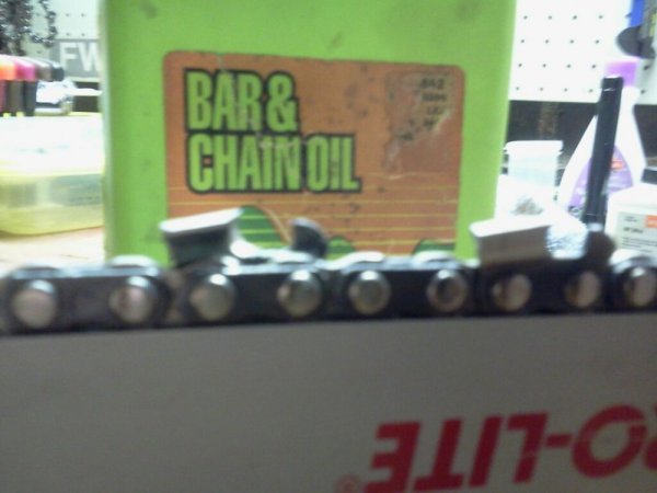

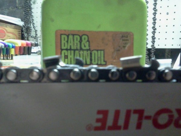

    This was the chain that was throwing dust last weekend. Tried to work on the "hook" and also rounded the rakers. Comments and suggestions welcome (including my pictures suck).
