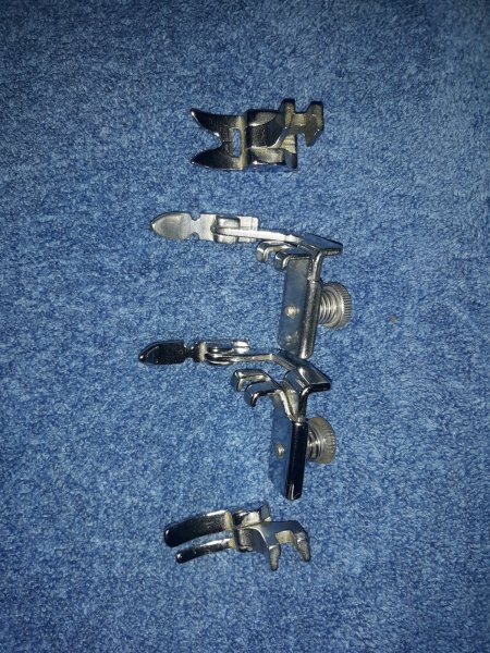

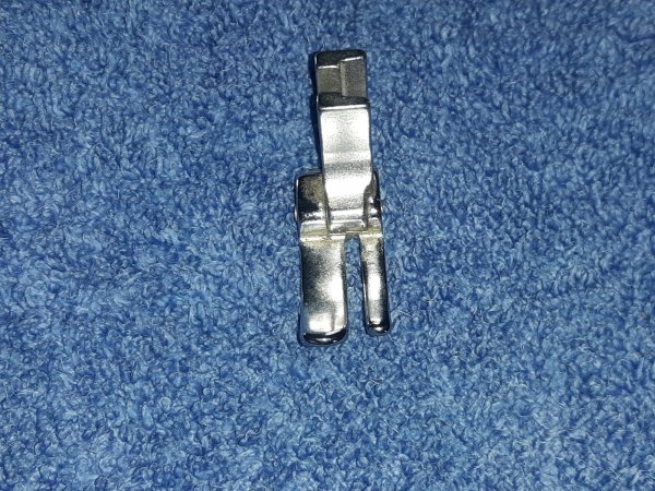

    Thanks woodwidow. Here are the feet it came with..... 20200518_101735.jpg 20200518_101632.jpg 20200518_101632.jpg would the foot on the bottom be sort of what you are talking about? there is only an eighth of an inch on the right side. the other feet are similar, but one appears to have heavier springs than the other one. I believe you about the quilting being cheaper to have sub contracted out. It is just something she wants to learn. I have old quilts my great grandmother made years ago. I think it just intrigues my daughter. Not a money making venture on the quilting for her, just a hobby.

    yes, that's the foot. If you measure from the needle when it is down, and out to the side, You should find 1/4" easily. Most quilt piece sewing uses 1/4" seams. If the edge of the foot isn't at 1/4" from the needle, then put a piece of tape down at the mark and use it for a guide for the seams. The more accurate you are with seam width, the easier it is to get consistent sizes of finished blocks.
    I learned this the hard way. When I started quilting, I just used the edge of the foot as a guide because it was close enough. Halfway through a quilt, I changed machines and did the same thing. Feet were different widths and it really mucked me up. Now I put a guide down with tape and stick to it.

    Thank You. That makes perfect sense. I did just measure the distance, and on straight stitch it is exactly a quarter of an inch. I really appreciate the advice.

    With your research, you probably know now that the two very similar feet are for installing zippers. The top wider foot, I would use for the majority of your sewing. If you don't get a buttonhole pattern cam, then you will probably be looking for a separate buttonhole attachment. If you are just using it for mending and tarp production, you won't be doing a lot of buttonholes.
