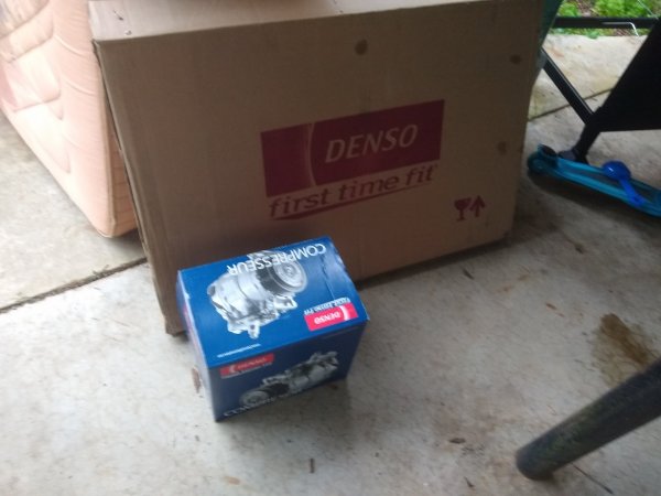

    Luckily last summer when it acted up I had went ahead and bought the Denso brand condenser and compressor off Amazon and had them in the shed. It s a good thing cause some stuff Amazon is deeming non essential there taking three weeks to ship to me even with prime and a prime item now with the virus. And Amazon prices killed everyone else's including Rock Auto.

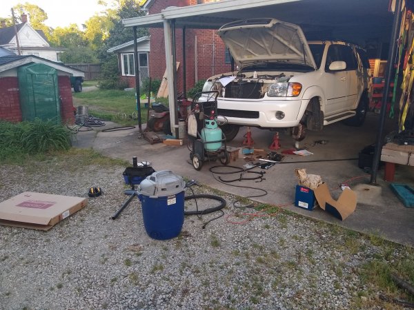

    So I went ahead and installed it all. One issue was the o rings I had were the wrong size so I had to go buy correct kit for Toyota. Also I thought I had a leak before charging it cause I could not hold a vacuum. It turned out to be the o ring in my machine lines. I realized this after pulling them off, noting the vacuum and then after reattaching it had not moved vacuum . So I put freon in it and heard it leaking at the low side fitting, which was the machine side coupler.

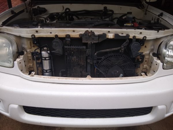

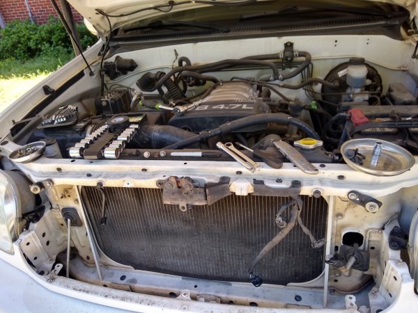

    Finally putting some pictures with this post. Just pics of the work but I know everyone loves pics. IMG_20200418_193907144.jpg IMG_20200418_131523152_HDR.jpg IMG_20200423_083158633.jpg IMG_20200423_083144464.jpg

    Also when u pulled the condenser out I found a 1/2" wrench that someone dropped infront of the radiator between it and the support. It was wedged against two cores of the radiator and had worn through one layer of metal and you could see a visible color change in the metal:eek:.
    It wasn't my wrench as I am not missing one and I don't have whatever set of cheapos that it was (I do have plenty of cheap tools, my good stuff is Pittsburgh:rofl: :lol:). I was glad I could it, wasn't too much longer before it probably sprang a leak there!! I cleaned it off with some brake clean and mixed up a little JB weld and smeared on those two small spots on the cores to give an extra layer of protection.
