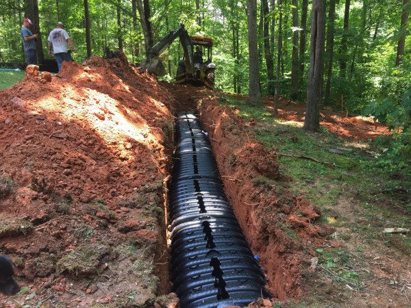

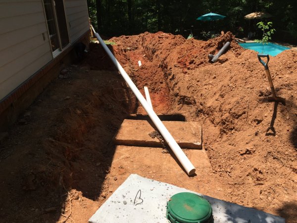

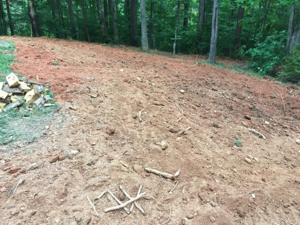

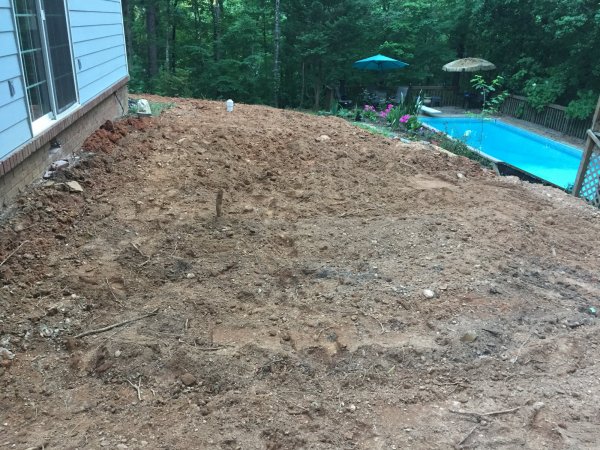

    IMG_1141.JPG IMG_1142.JPG IMG_1144.JPG IMG_1146.JPG IMG_1147.JPG So about 5hrs working time I have a working system :thumbs:
    We decided the existing tank was good with baffle.
    Turns out there was a leach field just not connected possibly due to roots or settling and it was taking water- we found a green outlet pipe a few feet from the tank and black pipe in gravel.
    Now there is ~180' of leach bed chamber with a cleanout for the tank and riser lid.

    What does the capped pipe above ground do? Is that what a "cleanout for the riser tank is"?
    Also, our new system ~ fall 2015 used similar or the same leachfield, but 2 rows at 100' .

    Is the black thing the leach bed chamber?
    Have never seen that.
