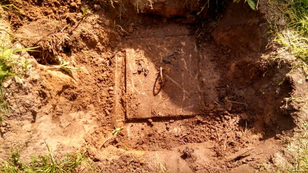

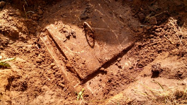

    FINALLY went back out today and uncovered the 2nd access lid.
    Lid closest to the house is about 21x17", and the other end (outlet) is only 16x16".
    We have our guy coming out on Friday to do a pump out and inspection. He has one of those cameras that he can run into the lines with video, so this should prove quite interesting.
    Here's a pic of the 2nd lid, and it looks like there's a small piece of root coming up between the lid and tank body. The root is the little clump at the left edge near the "bottom".

    145,557
    root from what? Tree?
  3. papadave
    Not sure, but it's about an inch or so thick. The remains of a Spruce I took down are about 20' from the tank.
    basod and wildwest like this.

  8. ansehnlich1
    ansehnlich1
    436
    1,807
    Nice looking lid, appears no effluent pushing up around it. If you wanted you could pull that and see where the water line is in the tank. If it's up to bottom of lid that ain't good, if it's down a couple inches that'd be a better sign.
    I'd consider buying a concrete riser and lid so you don't have to dig it out again.

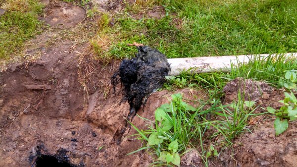

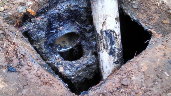

  19. papadave
    So, the guy showed up a while ago. He pulled the outlet lid and lo and behold there was a mass of small roots blocking it.
    Another driver was using the camera, so he's coming back later to scope it out. May need to clean the lines...........fingers crossed.
    This is the inlet side.
    Outlet side:headbang: You can maybe make out the fork he used to pull the roots away. There is what remains of a baffle made of concrete under there.
    basod, milleo, Loon and 3 others like this.

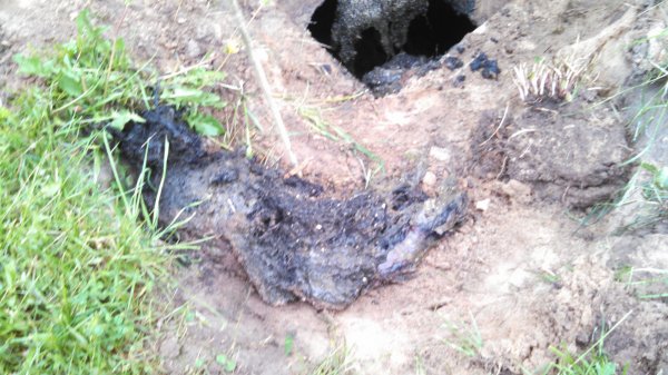

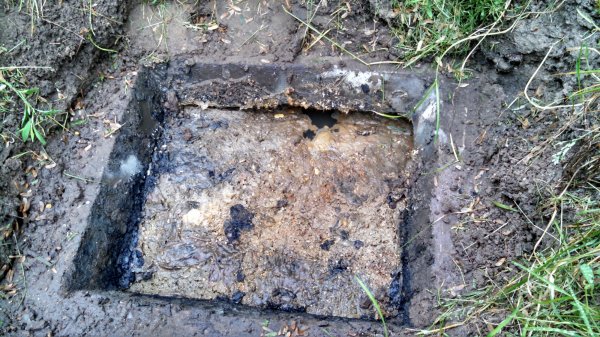

  20. papadave
    Here's about 1/2 of the roots pulled out.
    A bug chunk he dropped back into the tank and had to suck up.
    Remains of the baffle.
