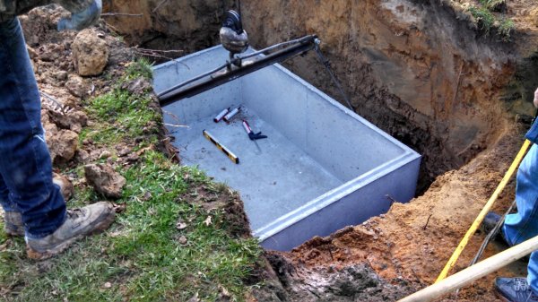

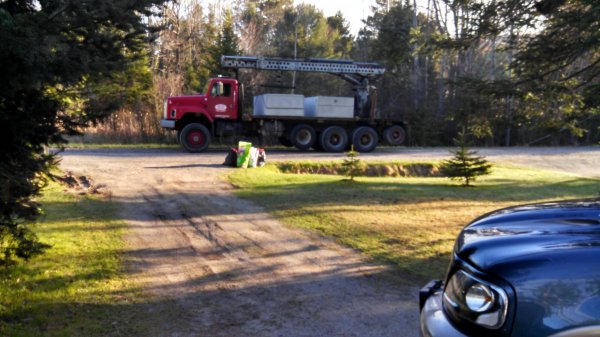

    Tank got here just before 8. The crew showed up about 7:15, and started digging the hole for the tank.
    Second time setting the tank, since the first one wasn't quite deep enough.

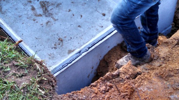

  9. papadave
    Top going on.

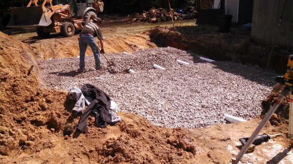

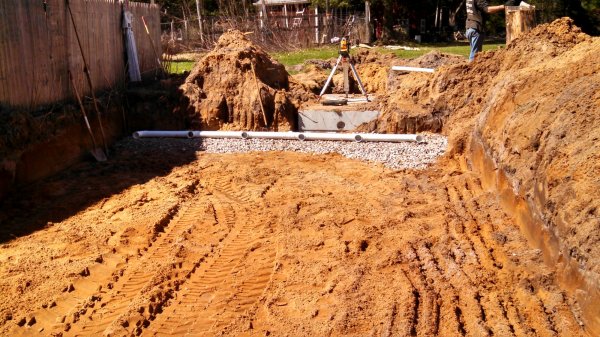

  10. papadave
    Two loads of gravel, and the bed being dug.

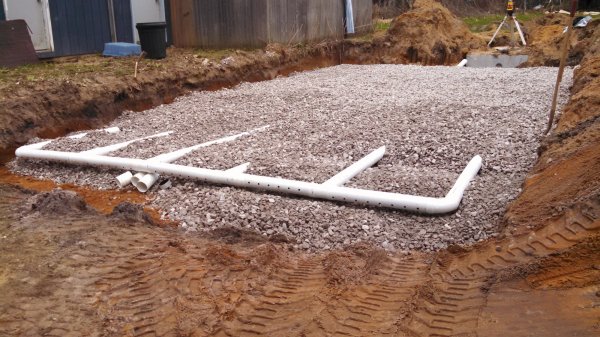

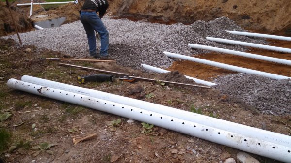

  11. papadave
    Lines going in......

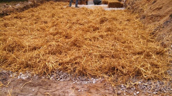

    The 2 young guys (one is the septic/excavator's son) should be back soon to do the hookup from the house to the new system.
    Boss came by for a bit and while he was waiting, he spread out the leftover gravel on some of the drive. :thumbs: IMG_20160502_160403_605.jpg IMG_20160502_160417_331.jpg

  17. papadave
    Still have to wait for the Health Dept. guy to inspect before covering it, but this was a pretty simple system.
    Having the right machinery makes short work of this kind of stuff.
    ETA: They put straw over the field............

  19. papadave
    When they started digging for the new line, they hit a couple of the existing ones, and effluent was pouring out of those for several minutes.
    Obviously, the old field was still not doing well.
    They told me the newer fields are aiming for 70/30. As in 70% evaporation and 30% drainage or infiltration into the ground.
    This field isn't anywhere near as deep as the old one.
    Septic guy also told me the old tank might have only been about 500 gallons.
