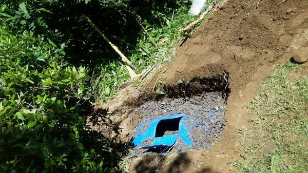

    Fun in the sun this morning!!:thumbs:
    Somebody pass me the freshener please.:dennis: Have to go back in to Tap-Con the one baffle.:cheers:

    Good to go for another 3 years.:smoke: Sprayed the top of the pipe with chlorine as there was some small roots coming through and the stream ya's can see is just the cold water tap from the kitchen sink I had mrs loon run.:yes:

    This is a settling tank for gray water. It is a large blue plastic barrel with a door on the side. The other side is full of holes for the gray water to settle out of. The tank is full of crushed stone. There is an over flow outlet.
