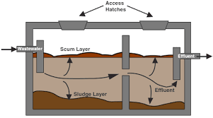

    This is a common tank, two access lids, you want to use the one on the end nearest your house.
    [​IMG][​IMG][​IMG]
    basod, Chvymn99, milleo and 3 others like this.

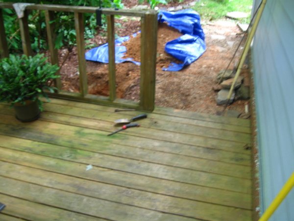

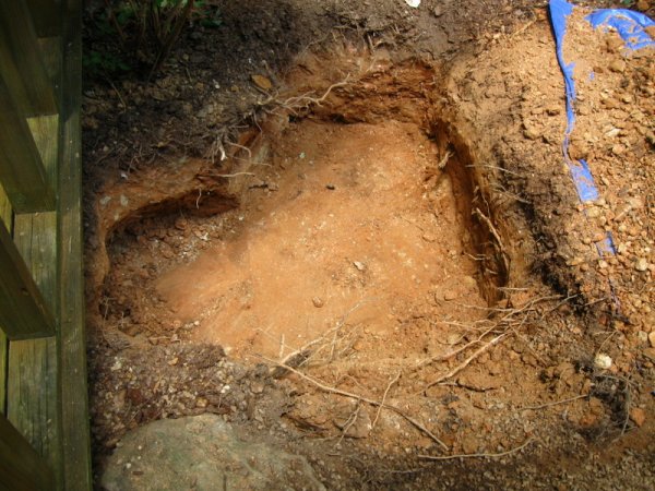

    The deck boards are 16' 2x6 all nailed down with 16 penny ring shanks - they ain't gonna come up without a fight
    Also sounds like a standard 4x8 sheet of plywood:D
    This where I'm at, no sign of rebar handle or seam. the end of the tank is approximately where the tarp is laid out and goes towards the deck

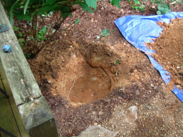

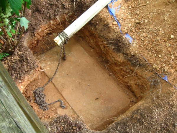

    Dug towards the deck and found a seam - started to wonder if the deck ended where it does because the lid is on the end.
    Moving to one side found a plastic coated cable and getting close to the other side but the sun is beating down on that spot, and then the skies turned black, down pouring now.
    Running out of room for dirt.
    Looking at the lifting cables I can't imagine they were strong enough to lift the whole tank but good for a 2x4' lid.

    We have liddage :thumbs: Hopefully not a casket lid
    It even moves a little bit with me bouncing on the other end of an 8' 4x4
