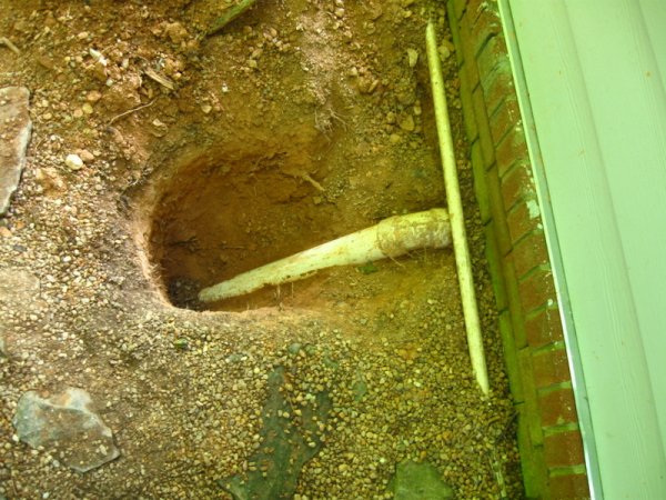

    Meant to add these - this is where I dug the outlet down 2-1/2' in our concrete clay
