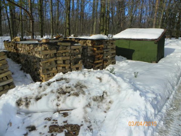

    This pile, as many know was cut the winter of 2008-2009 and split then stacked in early April 2009. We had burned a good amount of this but still had that far stack plus part of the other stack, which amounted to about 3 cord. That would have been enough for this winter without the other stuff so needless to say, we still have part of this for next year.
    However, I did not put quite 2 1/2 cord in the barn. I didn't want to open up one more stack and have that partial so I just stopped. Then, once again I started thinking. This time not so clearly.....
