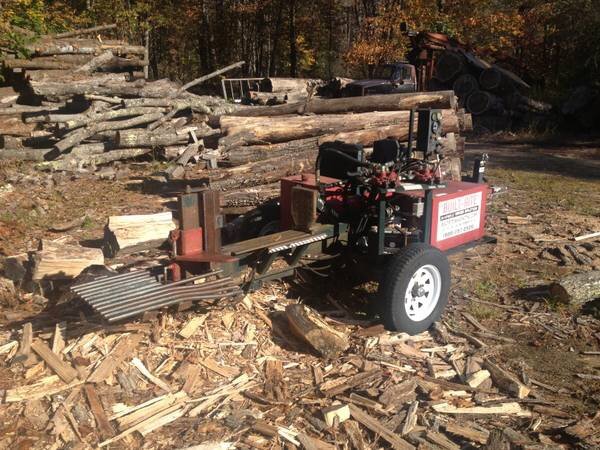

    I looked at the gravely tractors, they just don't have enough hp for what I want to do.
    I basically want to build a commercial style horizontal splitter. With log lift and adjustable splitting wedges etc. I'm going to combine the best ideas from several different brands.
    The self propelled concept is not my first design goal. But the more I think about it the more I like the idea. I could move the axle towards the front of the splitter; away from the work area. The tires wouldn't be in the way to trip over. I would put the jockey wheel under the beam below where the log lift would mount so it would be protected and out of the way as well.
    The splitter would be better balanced with that layout so no need for a drop down leg to keep the splitter from tipping up with heavy logs. And the whole thing would be more compact and shorter with no trailer tongue.
    But the biggest benefit would be being able to move it quickly a few feet at a time so the splits fall right where I want to stack them. Without having to use a tractor. It would be easier to spin it around and position right where I want to as well.
    With one of these
    But I'm not going to red neck it and graft a beam onto the tractor. I'd basically be tearing it apart into the various components and building from the pieces.
