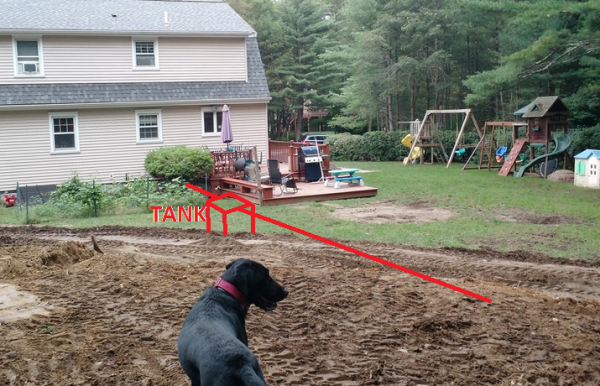

    If you know where the tank is you should be able to find all the corners of it by probing with a rod(I used a piece of rebar vice grips and hammer as my clay soil was like concrete this summer)
    The outlet "should be" in the center of the narrow side(usually4x8' tank)
    The probe depth of the tank and any slope in the ground towards the cesspool should tell you if the concrete is an additional seepage field - if that makes any sense?

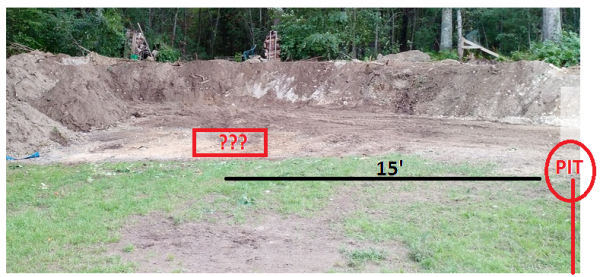

    I gotcha, here's some highly professional sketches of my chit-uation :p The mystery structure is a good 30 degree angle to the tank. I know the tank is square to house as the lid was. And yes, we have 2 swingsets.... don't ask; at least they were free and I just had to disassemble, haul and re-assemble.

    It's possible they added leaching chambers or galleys to the pit.
    The leaching field is dictated by number of bedrooms in the house. You figure in MA even back in 85 they had code requirements.

    This is the most likely scenario if my archaeology proves it is a true structure.

    if it's small could be a D box or distribution box to lines. depending on topography my guys would put bends in to keep it deep enough and pitch. Easier than hauling in more soil...
