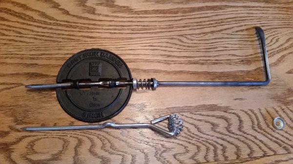

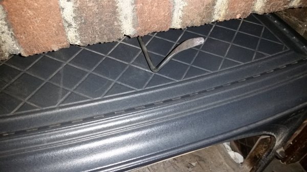

    I ended up installing a damper just above the stove. I only had a few inches of space to fit it in. I ended up forging an extended damper rod with thumb lever.
    The burn times seem longer and the secondaries are lasting longer. It works good on cold and windy days. Lever up is open, 1/4 turn is closed? It works great on very cold and windy days when the draft really pulls.
