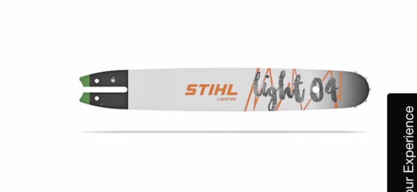

    The 250 takes a 3005 mount and the 261 is a 3003 you could do .325 on both saws but the drive counters are different. Also need to watch out for the newer saws with a light 04 bar and fancy paint job because your old chains won’t fit. The new light 04 is a .050 gauge instead of .063 like the older ms250 had. The new bar is slightly narrower with thinner rails to lighten it up a little and the .050 chain is a bit thinner kerf for faster cuts. 15-20% they claim and from what I hear it’s probably true, the new chains have a 23 on the front of the box.

    E5238603-0AF0-4EE2-B469-F114A1CCD923.png If the new bar on whatever saw you choose looks like this it will be the thin kerf .050 chain, you could buy this bar for your 250 in a 3005 mount and use the new chain on your 250, may even find this enough of an upgrade in speed to stay with the 250 for now. But I’m all for you buying at least another if not 2-4 more saws.

    The new .325 RSP chain is very good. So far I like the bar on my 261 too fwiw.
