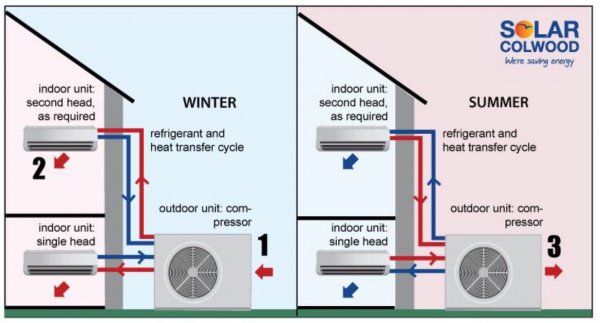

    Forced hot air is ducted heat from a furnace. Dave is talking about a mini-split, which is a wall mounted heating and A/C unit all in one. The units are hung on a wall in different areas of the living space and are controlled individually. They are electric, no gas or oil needed. They have their advantages and disadvantages. For a second home I would be ok with it, in my main home I wouldn't want one.

    Here's a mini-split ...
