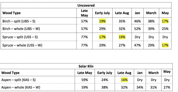

    Yes 19% & 17% is pretty good

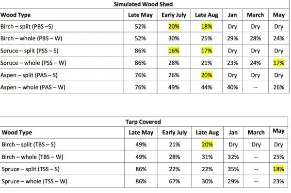

    Thought we discussed that study, and you even mentioned in another thread their solar kiln is not similar to mine and you saw design flaws in theirs.
    They used Birch Spruce and Aspen, all softwoods, the study by Cornell University for the Penn DNR, using hardwoods shows a different conclusion. So for soft woods open air and 23 months may be enough and the best method, I think we are all in agreement that 2-3 months in open air in not nearly enough for hardwoods, including maple and cherry.

    Again softwoods, not hardwoods. I agree that 2-3 months for pine, birch or aspen is great, they are all less dense woods than oak, hickory, or maple . 2-3 months air drying will not season oak, 2-3 months in a solar kiln using the methods I have described will.

    Covered:

    Birch is a hardwood
    eh?

    Birch has a density closer to softwoods than hardwoods.
    Birch, British0.6742
    Birch, European0.67
    Oak, American Red0.7445
    Oak, American White0.7747
    Oak, English Brown0.7445
    the density is a larger determinant of seasoning time than soft or hard. I apologize I want accurate with my statment
