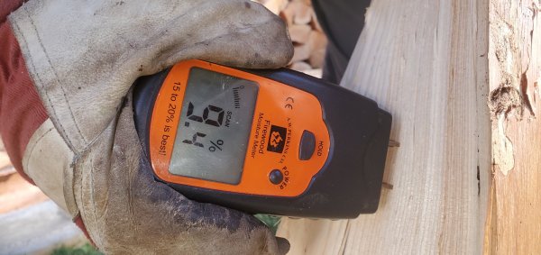

    I see someone above mentioned this already but I thought I would mention it again. It is recommended that wood be tested with a meter at 70f. If I want to measure a rounds mc I will bring it inside overnight and split it the next day once its warmed up. Wood drying in the round or standing dead is more common that people think. Here is a pic of the moisture content of a larch (19 mbtus) that was standing dead. I dropped it, bucked it and split it on October 2 of this year. Ive been burning it this last month. Its been very nice!

    I never noticed much difference in the moisture meter reading outside vs inside to speak of, never did any readings much below 40 degrees outside though.

    Some meters indicate that they need to be tested above a certain temperature. Others don't make mention of any temperature limitations, or have temperature compensation built in.
    TBH I haven't seen much difference in any regardless of temperature, as long as it's above freezing.

    I've had similar experience. I've checked fresh splits right off the splitter when outside in the cold, then brought it in to warm up for several hours. My meter showed very little difference. If I recall correctly, it was a point or 2.
