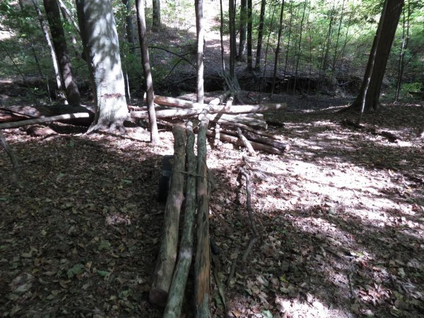

    Flat ground verses hilly is a game changer. Behind the house I've used my Magliner for long Ironwood blowdowns.
    Two wheeler is great for flat ground. Tips to easy on uneven terrain IMO. Single tire wheelbarrow works best for me.
    The Log mule looked pretty cool.

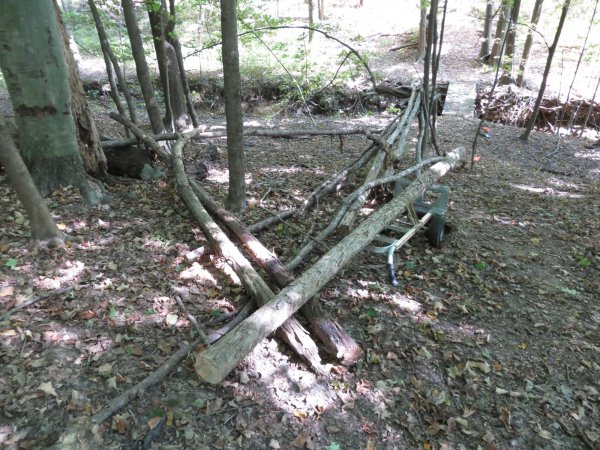

  2. FatBoy85
    FatBoy85
    Feb 25, 2017
    6,609
    25,244
    Washington State
    Usually I have not.... :whistle: I’ve used that hand cart and it is a stupid thing isn’t it?! But it does the job and I’ve placed stuff that was extremely heavy on that or my wheelbarrow to get it somewhere and as uneven ground disrupts it, will send it to the ground. I’ve brought my barrow to only a couple scrounges when there’s a lot of small stuff, this was awhile back though when I was scrounging on the daily.
