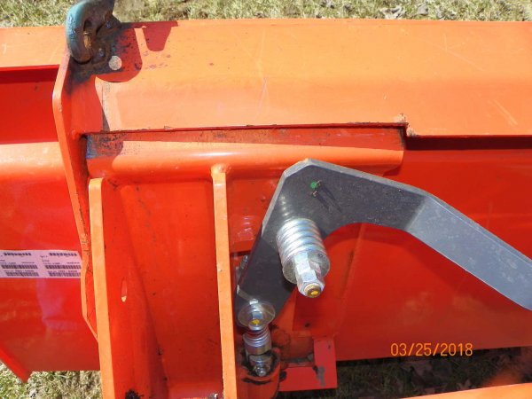

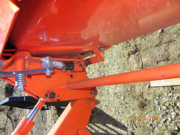

  14. Backwoods Savage
    48,112
    305,559
    Here are some pictures. The second one is with the bucket tipped back. The last picture shows how much it is off. I think I'll be able to straighten it myself but if not, the dealer should be able to. I probably won't get at this for a few days but will certainly try to get it back in line.

    If you are good (and lucky) you can just use the loaders hydraulics to straighten that back out. A log chain and some blocks of wood, and preferably a helper to either spot you, or run the lever...you can probably make it perfect again.

    Silly question maybe, but have you tried lifting the QA lever on that side and putting just a little pressure on the bucket to try to pop it into place enough for the pin to lock it in? That just might be close enough for that to work.

    I’m not sure you bent anything. Have you tried disconnecting the bucket completely and hooking it back up? In the pic it looks like you pushed the left pin down but it’s not where it should have been. Also try the forks again. Good luck sir.
