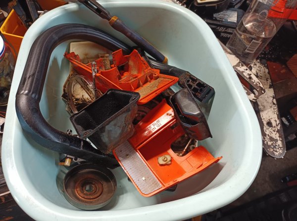

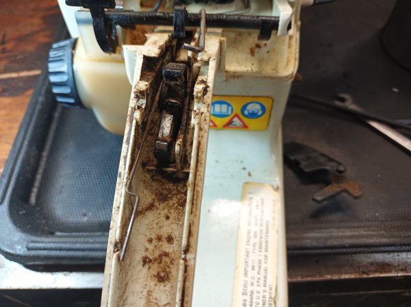

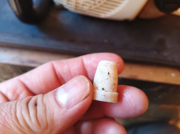

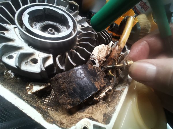

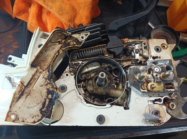

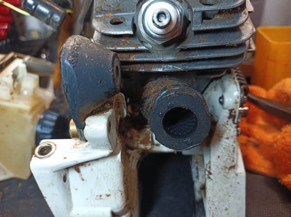

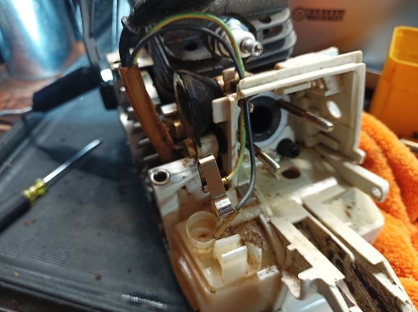

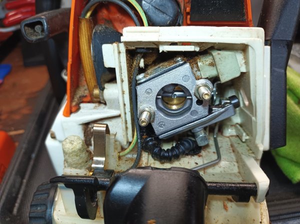

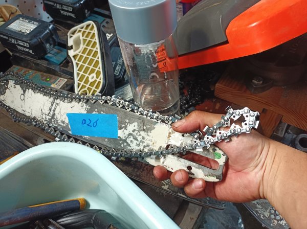

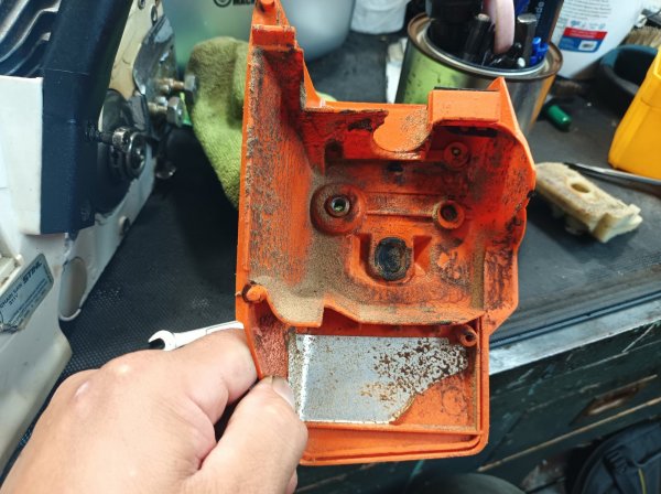

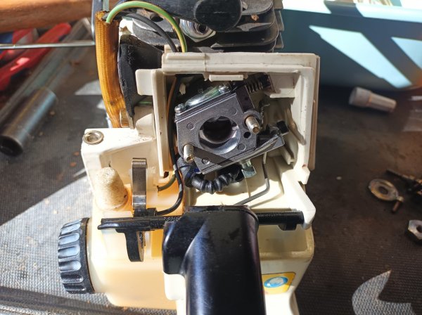

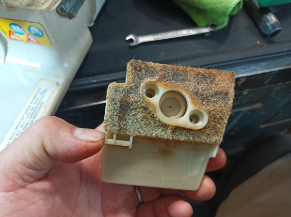

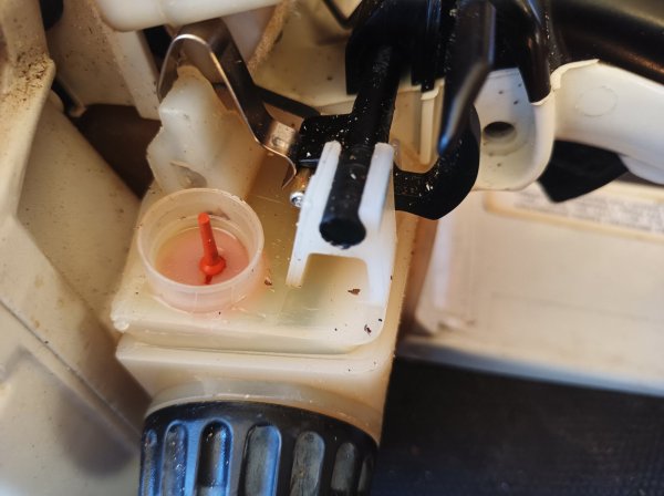

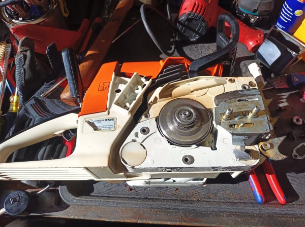

    Took the saw almost all the way down to give it a real good cleaning in the parts washer. It was filthy.
    Ran the carb through the ultrasonic using naptha inside of a beaker surrounded by water and that really cleared things up. Didn't need a carb kit.
    Had a spare stiff oil hose kit with the spring and ferrule (from when I rebuilt my 034 Super) and that worked out perfectly. I did mess up the first time and learned my lesson. Luckily I had enough hose to give it a second try. Used a heat gun to soften up that stiff line just enough.
    Put it back together this morning and she runs and oils. Came with a brand new never been sharpened RS 16" chain.
    Here are the before pics.

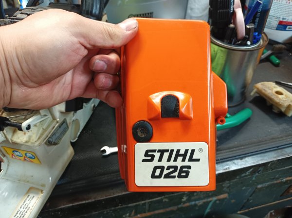

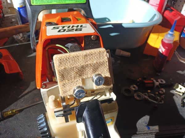

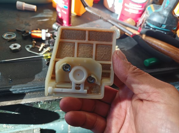

    And here are the after pics from this morning.
    The only thing missing is the cover for the tank vent. The rubber flap had a tiny tear in it but it does not appear to be leaking at the moment so I'll just leave it for now.
