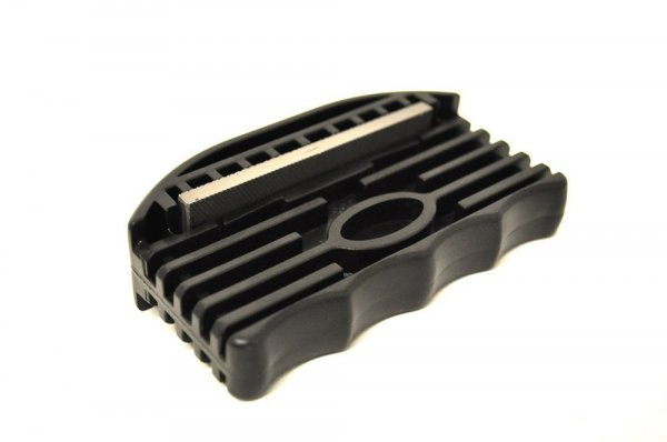

    I have a snowboard/ski file that I use to touch up my bar now and then; usually every time I flip the bar.
