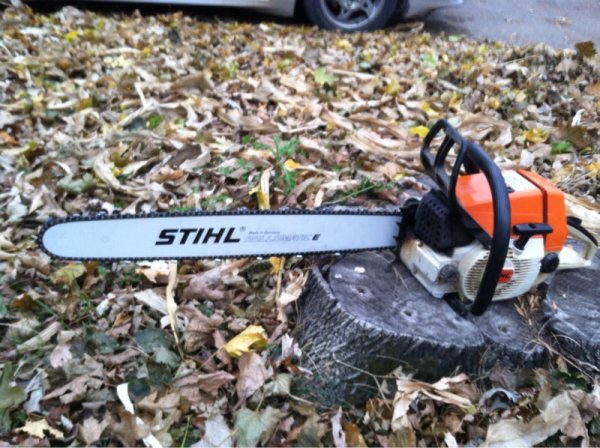

    Got the 25" bar, matching chains in full and semi chisel. Oh, and a full chisel 20" chain. (I own that stump, but I did not make that stump). image.jpg

    Did you say that so I wo7ld not say anything about the cut? : )
  11. Grizzly Adam
    Grizzly Adam Guest
    I expected someone to bust my chops about it. My brother and his Poulan Pro did that one.

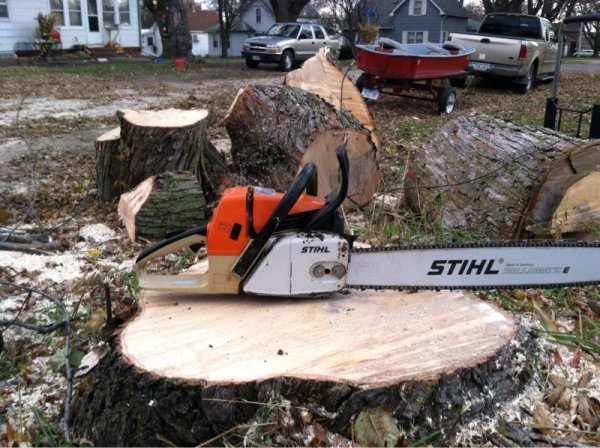

    Here it is on one of my stumps, Clem. This is the silver maple I took down today. image.jpg

    Nicely done Jack!

    looking good. Looks a lot like my stumps. Not saying I'm perfect or anything.
    But when my cousin and I use to cut he had a jacked up hinge that he cut closer to ground. I would cut like a round or two up when I felled a tree so that I then could go back and flush cut the stump.
