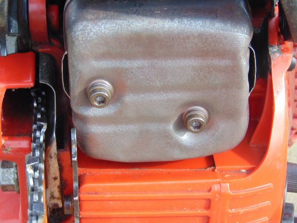

    Andrew added 2 gills in addition to the stock, so it's tri-port!

    Get a 346 brace on there so it doesn't vibrate loose and burn a hole in the tank. It's probably got plenty of opening for a work saw. Play it could go bigger.

    We did that a long time ago, but never took pics of the muff mod with the brace.

    Good. They sure need it
