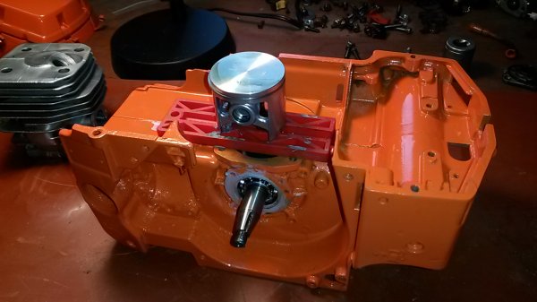

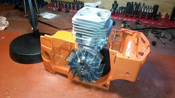

    20141128_072609.jpg 20141128_081223.jpg Shes comin along now!! Squish came in around .019. Yall think thats about right?
  18. DexterDay
    DexterDay Administrator
    12,411
    31,637
    Northeast Oh
    You building a NOS machine?
    Looks good!
    That .019" is the minimum. I don't think anyone would recommend going under that. Is that without base gasket?

    Its all a restoration Dex. Yea thats deleted base gasket and the squish ring cut in dome

    Sounds like you gotta winner on your hands here!!
