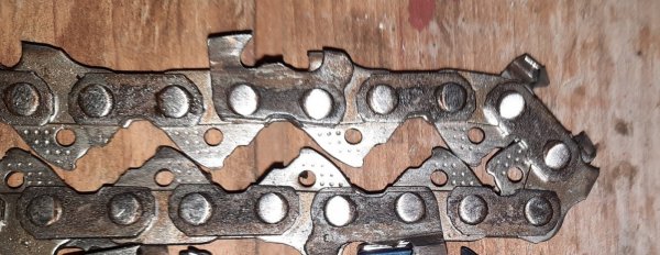

    Are the rakers too low? Hard to tell from pictures! Can you get a picture of the chain , tensioned, around the tip of the bar? If you ran it very tight, you may have wore down the bar. Just a guess
  2. thewoodlands
    thewoodlands
    15,040
    62,334

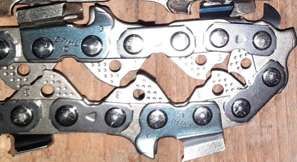

    I cropped the image, one picture of the old and another one of the new chain, hopefully it will help.

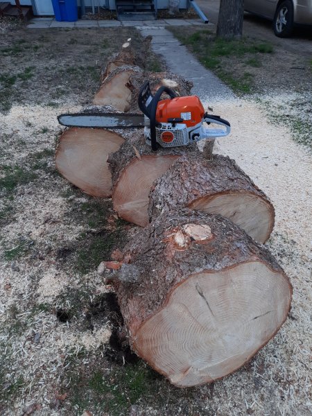

    Sorry I haven't been on here in a while. All issues were fixed with the new chain. 20210427_201451.jpg
    You can kinda see my bar in this one. The new chain went right through this spruce log, no problems, nice and straight cuts. I started thinking about just how much I have been using my chainsaw, and its a lot. But I know that I need to be more careful with the maintenance of my bars and chains.

    When I look at the picture of the old chain it looks like the gullet is to deep so the top of the cutter is not getting sharpened. Just my 2 cents.
  5. buZZsaw BRAD
    35,219
    218,153
    That was my thought too. Rakers seemed too low in the cropped picture.
  6. jo191145
    jo191145
    7,248
    50,549
    Ct
    That’s what I’m seeing too.
    Just to add, sometimes when you really chop up a rock or gravel. The chain is done for good. When that top plate gets heavily damaged may as well just toss it in the trash.
