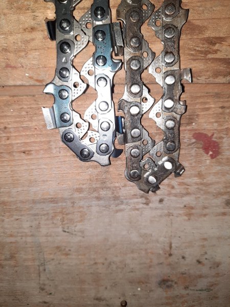

  15. SD Steve
    SD Steve
    Sep 2, 2019
    715
    4,837
    South Dakota
    Here is a picture of a new chain haging on a nail with an old chain. I knew that chains stretched but this is crazy. I never thought it would be so dramatic.
    This old chain was starting to top out the tensioner.
  16. The Wood Wolverine
    18,791
    120,875
    Can you count drive links to confirm they are the same? Maybe you are running tension too tight. And the safety bumpers, too me, look discolored. A sign they have been heated up, probably from excessive force. I also see some damage on the cutter itself that needs filed off so it cuts properly. That side place angle is wayyyy steep and looks like it was sharpened on a grinder. A couple pics at different angles of those cutters would help us hone in on what to advise you to change. Pulling up extra hard on the saw while cutting creates a few issues. One being excessive friction (and heat) on the bar and chain. How do your bar rails look at this point? Paint gone and discolored?

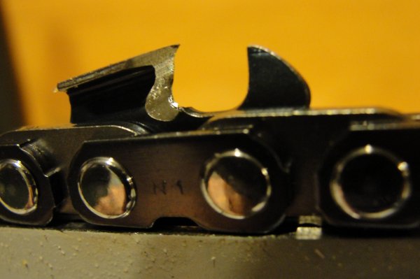

  18. The Wood Wolverine
    18,791
    120,875
    Doesn't look like it to me. Stihl has a profile that isn't perfectly round. Look closely at any new RS, as below.
  19. amateur cutter
    5,996
    48,757
    The RH cutters are rolled right over for sure, stone or metal hit? Chain sure looks like it got hot, I think Jason is right on.
