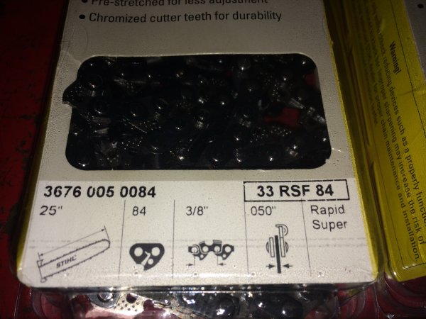

    Aren't the first two choices the same? RS and RS3 RS3 is "Single-Humped drive link" version of an RS chain, right?
    I find the chain docs very confusing... and apparently so do the dealers! I also wish they would include a file size code with each. So the below chain SHOULD be: 25" 84 3/8" 0.05" Rapid Super 13/64" (file size)

    How do I go about getting one of these? ;) I want one..

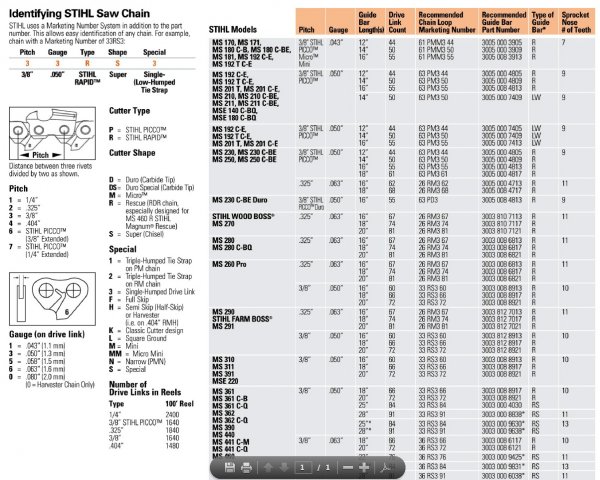

  3. bogydave
    RS3 has a safety hump to reduce kick back
    RS no safety hump
    RSF is RS full skip tooth chain.

    still 3/8 chain has always used 13/64 although the oregon and carlton use 7/32"... also stihl changed their bars slightly this year and the 84DL 25" chain is now a 85DL... that will be interesting in a few years...

    What's the "C" stand for on the side of the Stihl chains?
