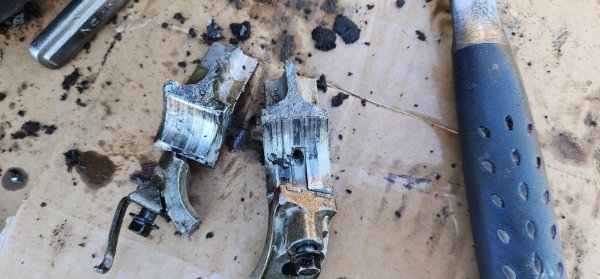

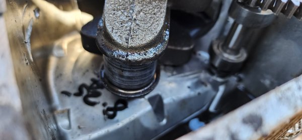

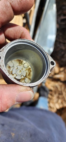

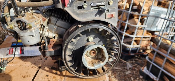

    Good find. Kinda figured rod was broken when you said piston didn't move. That had to have made some kinda noise when it let go. Was the operator using ear protection cause i don't remember you mentioning it making any noise when it quit.

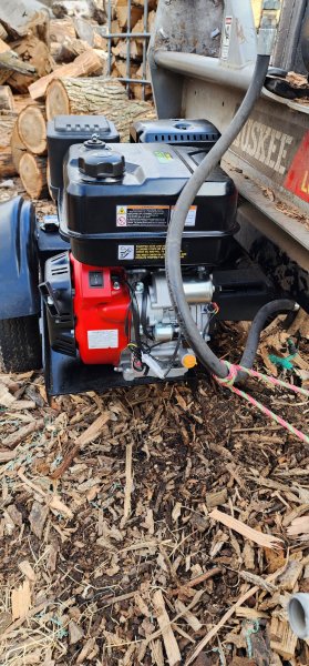

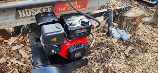

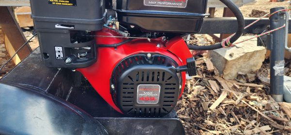

    Looked at the 13-HP but hated the way the air filter looked, what a joke. Went with the 15.8-HP and no major problems getting it mounted. Started first pull and motor doesn't slow down a bit when you hit a tough to split area.

    He does but I knew it was done when I pulled it over after it stopped the first time. Be happy if we can get 14 years out of this one. Not sure if it's all low oil related or just fatigue.

    Got access to a cheap deep cycle battery and should have a case for, so thinking about connecting the electric start. As though I am not lazy enough to pull the rope.:D Can't tell for sure if they used reducers for the 1/2" hoses or not, but guessing they didn't so doubt a 22 gallon pump is in the future.
    Edwin is excited to have the splitter back in service and can't believe it only took me a week from when the old motor self-destructed.
