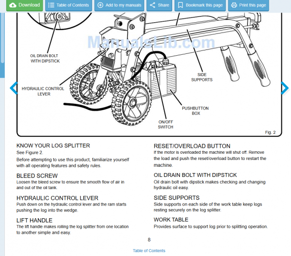

  4. brenndatomu
    25,107
    163,144
    Do you have this "bleed screw" that they mention here? Is it open?
    eatonpcat, metalcuttr and theburtman like this.
  5. cezar
    cezar
    Oct 12, 2021
    472
    1,940
    KY
    Yeah that is my exact splitter. Yes it's open.

  7. brenndatomu
    25,107
    163,144
    This is it 10 Ton Electric Log Splitter
