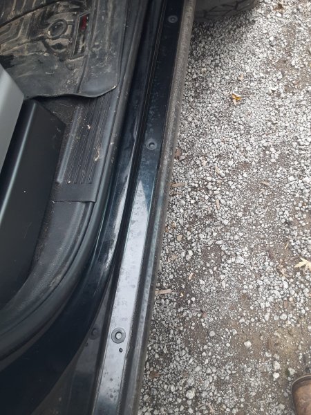

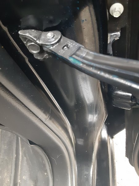

    Northeast Ohio....Bowdil
    They get inside everywhere. Drill, spray, then plug. I did have to let it drip a few days then wash and wax due to the overspray. 16979937635326262484213157477091.jpg 16979937945786446845652889173723.jpg

    That 2nd pic shows residual oil still present.
    metalcuttr, eatonpcat and brenndatomu like this.

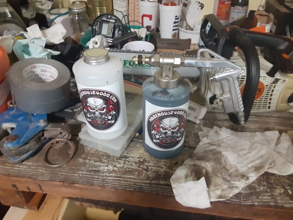

    Ahh, gotcha. I was gonna say, FF is thicc.

    This stuff doesn't dry hard. Does fluid film? I have to wash it off the do if they decide to get under my truck.
