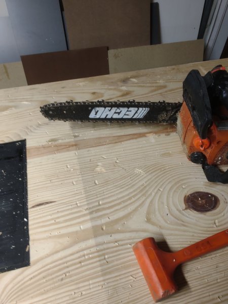

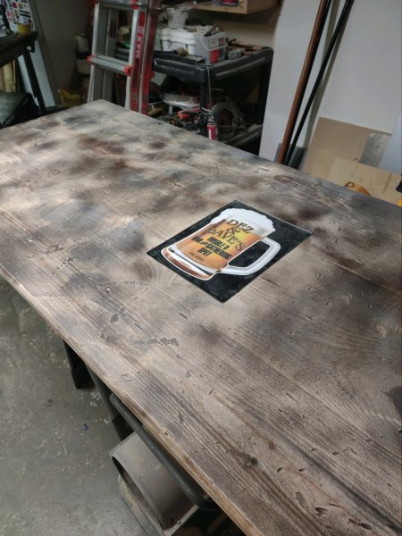

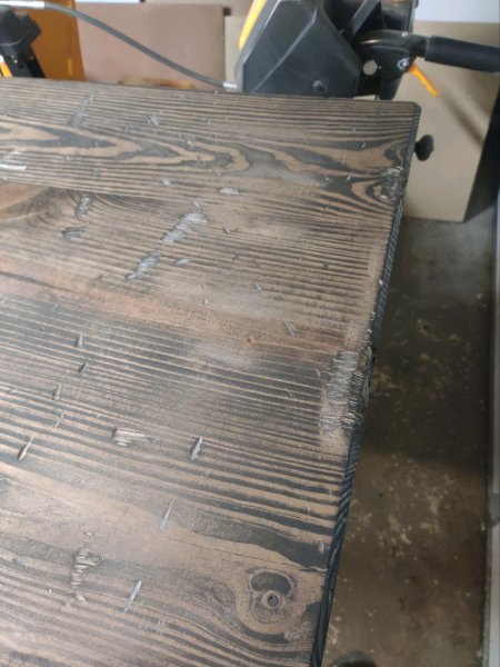

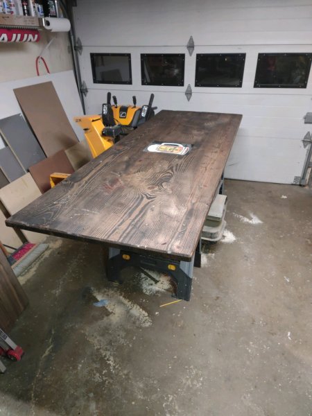

    68412.jpeg Building a portable bar for my younger cousins garage. Used SPF framing lumber. Took a piece of chain with a Master Lock on it to the top. Then fired up the Echo 355t to add some more character. Put some spray paint in the divots. Just wiped on a light coat of stain. 2 coats of Conversion Lacquer and I'm done. Nice building something that doesn't have to flawless a d a perfect surface. 68411.jpeg

    Looking good, Nice work!

    Nice work...like the name of the bar also!

    Nice Job John.
