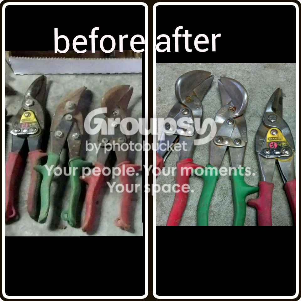

    Saw this on another forum
    He used one cup of salt per gallon of vinegar for the 'brine'

    Not my pics -- but I want to try it on a few tools.

    My buddy uses a plastic tub with water and baking soda and hangs two old mower blades in it for electrodes and hooks his battery charge up to it.

    I did that experiment a few years back gary man does it work! Now I have another to try.:D

    Like these guys? http://www.metaldipping.com/faq.php
    I've heard of using "washing soda"... Not sure if there is a chemical difference between baking soda and washing soda..
    Additionally, I've heard that you SHOULD NOT do this with stainless steel due to the noxious fumes produced from the chemicals that are used in making the steel stainless.

    This seems quicker and easier then using electrodes and battery chargers. Just dump some salt and vinegar in a bucket and wait.

    Washing soda is the same as baking soda - just not food quality
