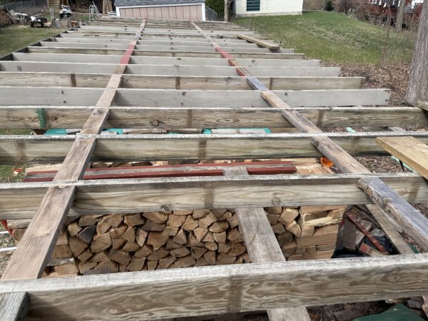

    Blocking/bridging complete. Had just enough of a hodge podge mix of 2X4s on hand to do it.

    So after getting all the bridging in today, I finished installing all the hurricane ties on the rafters on the low side of the roof. Then I added gussets to stabilize the structure front to back. It’s a big improvement and I’m hoping it’ll get even more solid once I sheath the roof. I had just enough steam left to start sheathing then the wind picked up something fierce. No way I’m going to be on top of that today, wrestling sheets of OSB with the wind howling.

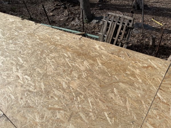

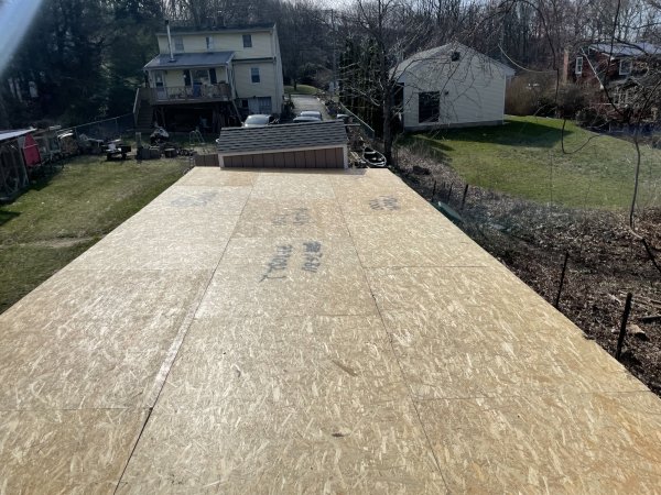

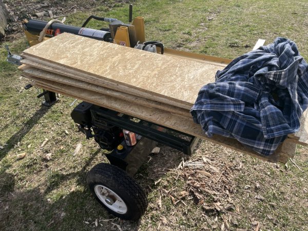

    There was a slight breeze for most of the day today but I was on a mission. Started this morning in a flannel and ended up in a T-shirt by noon. Gorgeous sunny April day with a high of 50. Perfect for working outside. Sheathing is finished. I had *just* enough OSB to cover the roof. Unfortunately on the last course I was really scraping the bottom of the barrel using the damaged sheets I had. The edge of the low side of the roof will have to get trimmed back about 6”. Basically the overhang on that side will be reduced by half. Not a deal breaker though. All in all a productive day/week in general. I’ll have to install some drip edge before the rolled roofing goes down. I’m in the home stretch at least.
    The bad edge that’ll have to get trimmed back, along with the rafter tails.
    The leftover scraps I can repurpose in the future.
