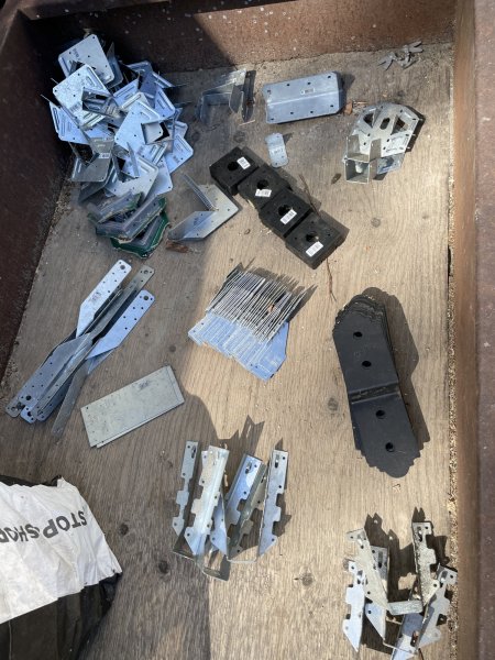

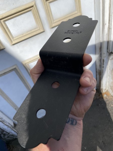

    I dug up all the spare hardware I had kicking around that was left over from when I built my deck in 2020. Looks like I have enough hurricane ties for the rafters.
    But even better, I have these heavy duty Simpson brackets that’ll both support the second layer of 2x6 beams, but add a little aesthetic appeal in the process :thumbs:

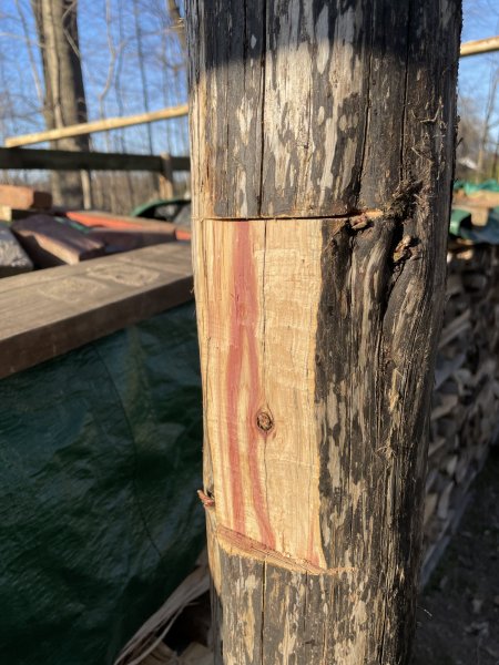

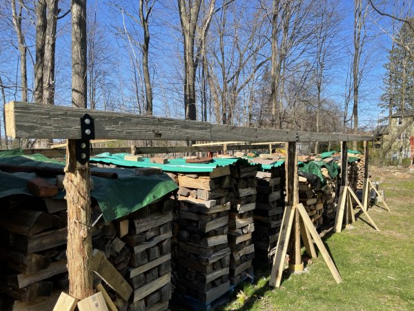

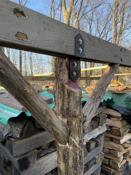

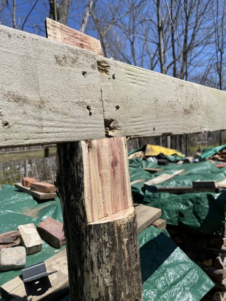

    Got the posts flush notched (that’s what I’m calling it :)) for the Simpson steel brackets. Brackets installed, and the beams are doubled up with more 2x6’s.

    Started on the 45 degree lateral supports. Made an upper and lower horizontal cut with my hand saw, then hammered and chiseled a somewhat flat surface. This part is real work :picard: I was going to go with 4x4 pine, but it looked wonky. I have enough smaller diameter cedar to where that’s what I’ll use. To fasten the 45’s to the post and beam, I used some 6” steel spikes I had on hand. Also added a beveled edge to the post for a little style while I was at it.

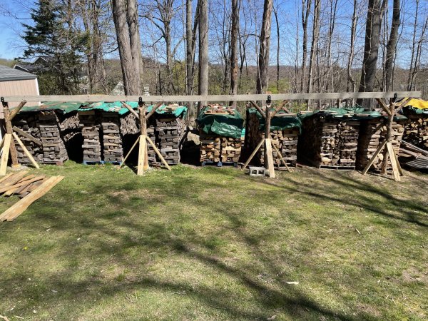

  20. Eric Wanderweg
    8,753
    69,612
