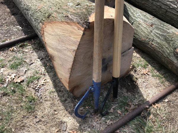

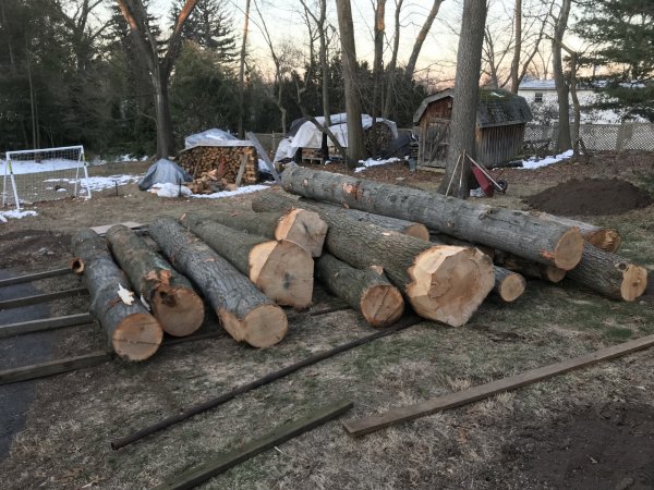

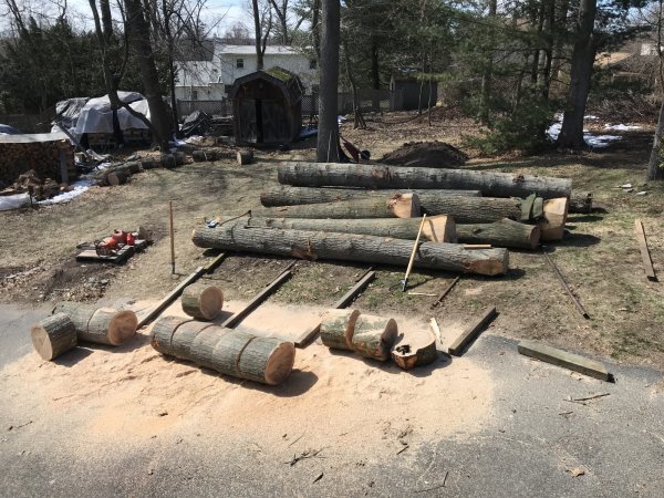

    The only thing that will keep you from rolling the first log is the dirt packed up against it. So long as the ground is even and the log is round a 60" peavey can roll just about anything. Your logs should be no problem to roll. Just be careful that one doesn't roll you over. I have my guy lay out logs flat as possible
    I have a cant hook and peavey from Peavey Tools Standard Peavey. Can't go wrong.
    These are from my 2018 load.
