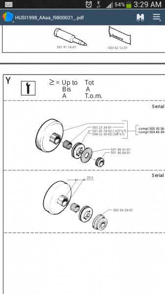

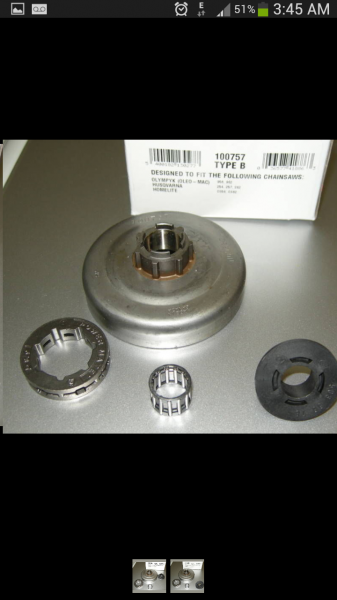

    That's the way the hub on the Dolmar 111i differs on the 1997 and later saws for the part time oil pump drive.

    I dont see any reason it wouldnt work? All parts look common except in the 2nd drum they make note of 20.5mm?
