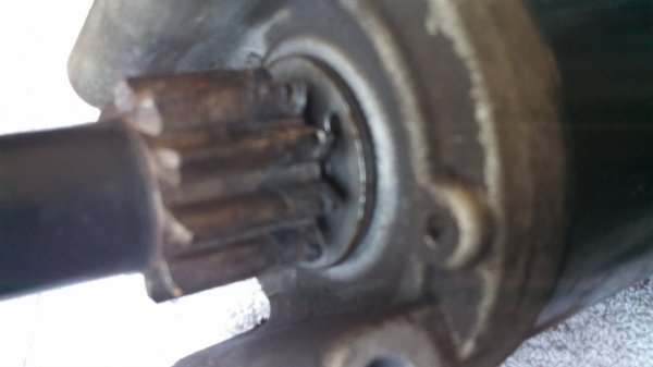

    How does the cap come off?
    Don't want to break anything. Tried pulling, and unscrewing.......didn't work.

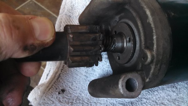

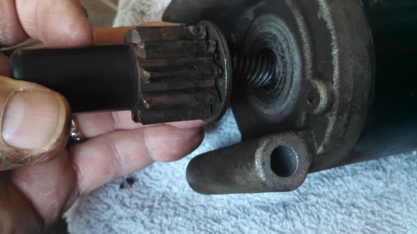

  3. papadave
    So, I'm seeing remnants of the shroud on the gear. Must be it came loose and got shredded/melted to the gear.
    The plate under the gear has no way to stay with the gear, if that's what it's supposed to do.
    I can pry it up and get it to screw up the spiral pinion gear, but it didn't do it on the tractor.

  5. Screwloose
    Screwloose
    Jan 15, 2017
    5,698
    33,836
    Well..... Your SUPPOSED to just toss money at it and buy a new......
    It snaps into a groove tightly, try heat (heat gun, hair dryer) and a screwdriver to "pop" it off.
    Second option, clean and lightly lube while working it fully up and down and praying fine dusty crap isn't inside.
    Third option, my favorite......Cut the dang thing off and pretend you never saw it as most starters don't use them, they collect crap and they prevent you from servicing it regularly.

    If that plate came unattached from the gear I'll bet it a weight meant to stall the rotational acceleration of the gear. Can you look and see if they wuz once one ?
    Horkn likes this.
  11. Screwloose
    Screwloose
    Jan 15, 2017
    5,698
    33,836
    Like is the "melted shroud" actually the failed bonding agent ?
    Horkn likes this.

  13. Screwloose
    Screwloose
    Jan 15, 2017
    5,698
    33,836
    Looking at the pictures again I'll guess the 3 holes in the "washer" are the anchor points and something sheared separating it from the gear.
    Horkn and papadave like this.
  14. papadave
    Yep, my exact thought.
    That "washer" actually spins up the shaft, so I'm thinking it's supposed to be attached to the gear via the missing shroud.
    Horkn and Screwloose like this.

  20. papadave
    So, the starter showed up a few days ago, and I finally got a chance to put it on. maybe,...maybe, 5 minutes and Wow, what a difference in how easily this spins the motor. Needed some choking, but started up on the 3rd try.:thumbs:
