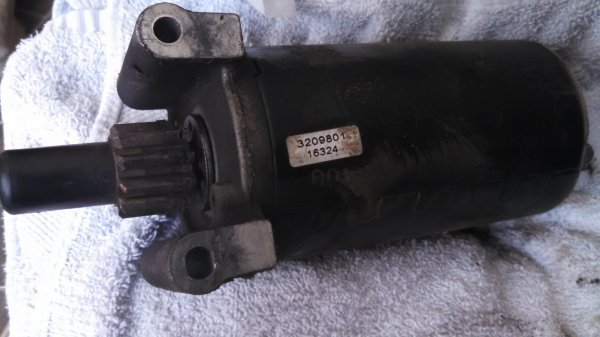

    Finally had a fairly nice day, no snow, and a little warmer.......pulled the starter, after trying to start again, and the gear is just spinning, but stuck in the up position.
    Squirted a little PB on it and it dropped back down, but still won't catch the flywheel.
    Looks like there's a small cap/shroud or something missing that should attach to the bottom part of the teeth, but no idea if that would have anything to do with the issue.
    Here's a pic............

    That was a good hint, "it dropped down". Under the black plastic cap is a "Bendix" essentially a "screw cut" motor shaft and female threaded gear. In operation you turn the key the motor shaft starts spinning, the gear not turning instantly says WTH and screws up the shaft. It then pushes the gear into the flywheel and since the flywheel is not turning twisting force holds it up and spins the engine. When the engine starts the faster turning flywheel overcomes the speed of the motor shaft and the gear spins down the screw.
    Long winded but look under the black cap as the gear needs to be free, extra free to run up and down the "screw" . NO heavy grease... Lil white lube or ?
    And remember the mounting points and bolts "are" your second wire.
